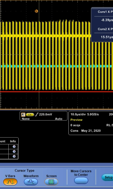

Hello everyone,
my development board is IMX7DSABRE. Linux kernel version is 4.9.88.
In the process of using eim for data transmission, I found that for every 32 bytes transmitted by the eim bus, there will be a certain idle time, and then I continue to transmit data. At first, I sent and received data through DMA, and found that there was a gap every 32 bytes. I thought it was caused by DMA. Later I found that I use non-dma way, there is still a gap every 32 bytes. Why is there a certain interval every 32 bytes transferred? This interval reduces the transmission speed of the eim bus. Is there any way to solve this interval? I found this problem on imx6d and imx7d.
The interval time is as follows:

Yuri
  The issue relates to internal architecture of i.MX  devices, which is very complex
and is not optimized  especially for  fastest EIM operations.
Yuri.

864535720
Do you plan to optimize this time interval during EIM transmission? Is there any other way to increase the transmission rate of EIM?

Yuri
864535720@qq.com
  There are no plans regarding the EIM. Such interfaces as PCIe, USB are intended for high
speed ops.
