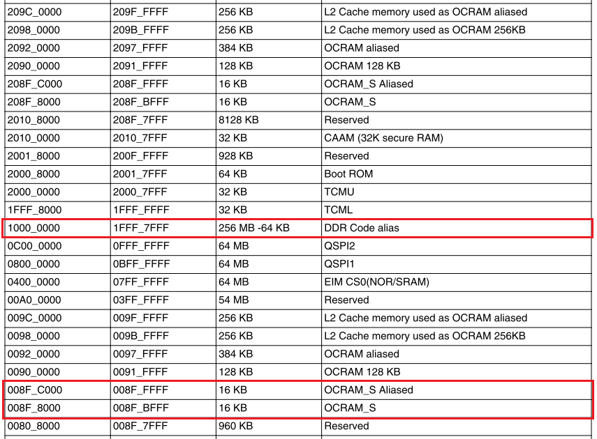

I read the IMX6SXRM (i.MX 6SoloX Applications Processor Reference Manual)
At page 196, there is a line:
1000_0000 1FFF_7FFF 256 MB -64 KB DDR Code alias
Whose alias is it? What is the start address?

  For CM4 :
DDR address space is 0x8000_0000 – 0xDFFF_FFFF
and its alias :
0x1000_0000 - 0x1FFF_7FFF,
where 0x8000_0000 corresponds 0x1000_0000
Yuri.

mileswang
Dear Yuri,
Sorry. I don't understand your answer. Below is a part of the CM4 memory map:
I can understand "OCRAM_S Aliased" is the alias of OCRAM_S. They are pointer to same memory region.
Then who is the alias of "DDR Code alias" (1000_000 to 1FFF_7FFF)?
Miles

Yuri
  For CM4 :
and its alias :
Yuri.
