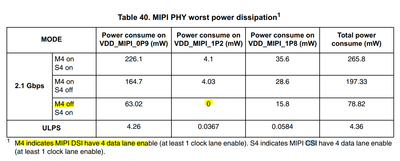

2)  From the datashee of PCA9450A, additional LDO is recommended to supply 1.2V to VDD_MIPI_1P2.
  According to desing concept, Customer has idea not using MIPI-DSI. So he wants not to connect VDD_MIPI_1P2 because table 40.  Power consumption of VDD_MIPI_1P2 on MIPI PHY wrost power dissipation of datasheet  is Zero mw  when MIPI DSI isn't enabled.
 is it possible to float VDD_MIPI_1P2 ball when MIPI DSI isn't used?

Only if MIPI-CSI and MIPI-DSI are not used:
- VDD_MIPI_1P8, VDD_MIPI_1P2, VDD_MIPI_0P9 can be left unconnected.
- MIPI_CSI_CLK_P/N, MIPI_CSI_Dx_P/N should be tied to ground.
- MIPI_DSI_CLK_P/N, MIPI_DSI_Dx_P/N, MIPI_VREG_CAP can be left unconnected.
