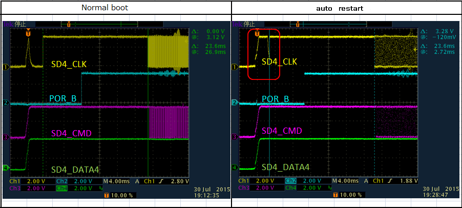

Dear All,
[Overview]
Device : i.MX6DL + PF0100A
OS/Version : Linux L3.0.35_4.1.0
Issue : Repeart the Re-boot
Failure rate : 10 per 22,000units (Very rare units)
Target Board : Custom board
Detail :
The custom board boot-up from eMMC.
But, the failure board repeat the re-boot because of changing the status bit on eMMC (DEVICE is locked).
My customer measured the waveform between i.MX and eMMC at boot-up.
The waveform found the different about behavior of SD4_CLK.
*Refer to below waveform.
We want to confirm the whether or not right operation.
[Question]
Could you give me an advice about the possible causes?
(Does On-chip boot ROM in i.MX6 have an influence?)
Keita
ラベル(3)
16 返答(返信)
7,196件の閲覧回数
art
Please take a look at the "auto restart" screenshot, the POR_B (blue) trace under the red rectangle, highlighting the abnormal glitch on the SD4_CLK signal. You can see a short glitch on the POR_B signal, that can affect the normal boot sequence. The presence of the glitch points to the fact that either the power-up sequence is violated or the initial ramp-up of a main power is unstable. Please double-check that points.
Artur

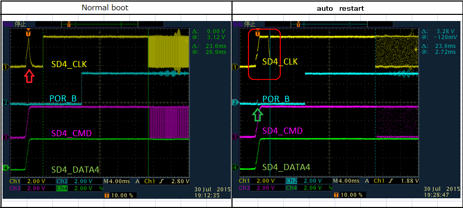

Hi Artur,
Thank you for your reply.
Refer to below waveform again.
[Q1]
Refer to red arrow in the "Normal boot".
- Why does glitch on the SD4_CLK occur? (We want to know the mechanism.)
  The red arrow looks not glitch. I think that Internal 100kOhm Pull-up effect at the red arrow point.
  After that, i.MX6 forces to Low on the SD4_CLK line, isn't it?
- Is this glitch right operation?
- And, Is there possibility that the glitch has an influence on boot?
- Is the factor of glitch i.MX6? (or external eMMC)?
[Q2]
Refer to green arrow in the "auto restart".
Is this your mentioned point?
The glitch is very small. So I consider that the glitch cannot affect the boot sequence.
Keita
7,196件の閲覧回数
art
A1. The glitch you've pointed by the red arrow just follows the initial power
ramp-up until the internal reset occurs and the SD4_CLK pin switches to its SDHC
function. It is produced by i.MX6, it is normal and does not affect the boot
procedure.
A2. Yes, I mean the glitch you've pointed by the green arrow on the "auto
restart" screenshot. It _can_ affect the boot sequence, although you may not see
it clearly on the oscilloscope. Especially, if it is caused by a main power
instability during initial power-up. So, double-check what's wrong with the main
power on malfunctioning boards.
Artur

Hi Artur,
Hello. I update the below thing.
My customer measured the detail waveform about POR_B glitch with hot & cold temperature.
Refer to attached file.
We didn't find the critical glitch.
Keita

keitanagashima
Senior Contributor I
Dear Yuri,
Hello. Thank you for your reply.
We want to understand about SD4_CLK behavior.
Refer to the "SD4_CLK_Operation(150828).xlsx" file again.
[Q1]
We think that the SD4_CLK behavior caused by i.MX6 output.
How do you think?
[Q2]
> in particular : number, nomenclature and location of (bulk) capacitors.
Where capacitor did you point out?
[Q3]
I referred the check list and found the only below item.
Could you check it?
[From HW Design Checking List for i.MX6DQSDL (Rev.2.8)]
NAND_RE and SDx_CLK are loop back as internal reference clock at internal  pad, recommend adding a series 0hom resister on these two signals and place near i.Mx6 pin side to reduce the potential reflect SI issue.”
Keita

keitanagashima
Hi Artur,
> function.
Refer to attached file [SD4_CLK_Operation(150828).xlsx].
The SD4_CLK waveform changed dependent on the temperature of i.MX6DL.
[Q1]
Is SD4_CLK was right operation as i.MX6DL(SDHC)?
[Q2]
Why does it become such operation dependent on the temperature?
Keita
