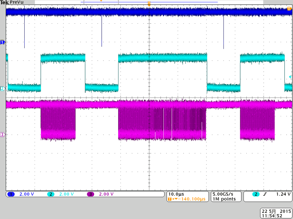

We connect an LCD panel to i.MX25.
(LCD:  688 x 600 / 24bpp / 44.3MHz)
We have the problem that a noise is over to LCD.
A white line and a black line are displayed.
We checked a waveform of VSYNC and HSYNC.
We found the waveform of VSYNC and HSYNC dropouted.
[VSYNC]   Blue: VSYNC / Aqua: DE
[HSYNC]  Blue: HSYNC / Aqua: OE / Red: LD
When dropout of VSYNC and HSYNC occurred, it seems that underrun error occurs.
LISR=0x0000000B
Can the underrun error become the cause that dropout of VSYNC and HSYNC occurs?
If it is Yes,
May I have advice about a method avoiding Underrun error?

Hi Yuuki
in general yes, this may be caused by underruns,
you can test that reducing lcd framerate.
For avoiding underruns one can try to place lcd buffer
in iRAM.
igor

Can use of iRAM solve a problem?
iRAM size is 128KByte.
However, The size required for LCD Buffer is about 1.2MByte.
  686 x 600 x 3Byte = 1234800 Byte (about 1.2MByte)
I think that size of iRAM is not enough.

igorpadykov
Hi Yuuki
you are right, only small size LCD can be used with iRAM
igor

I think that iRAM use does not become workaround for this problem because iRAM size is very small.
Is there the method to avoid this problem, other than iRAM use?
May I have advice?

igorpadykov
Hi Yuuki
I think onlt way to decrease bus load: decrease LCD frame rate,
bits/per pixel or size
