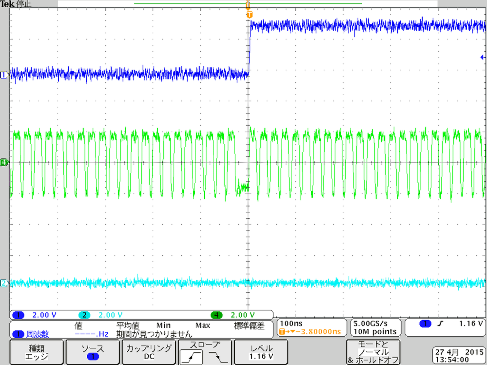

Dear all,
We connect an LCD panel to i.MX25.
We observed a waveform of OE and LSCLK.
When OE signal changes in High, LSCLK drops out 1clk.
(It occurs in every rising of the OE signal.)
Please see the following figure.
We investigate this cause.
May I have any advice?

Hi Yuuki
plaese check TLSbo95476 LCDC: LSCLK is missing
IMX25CE Chip Errata for the i.MX25
