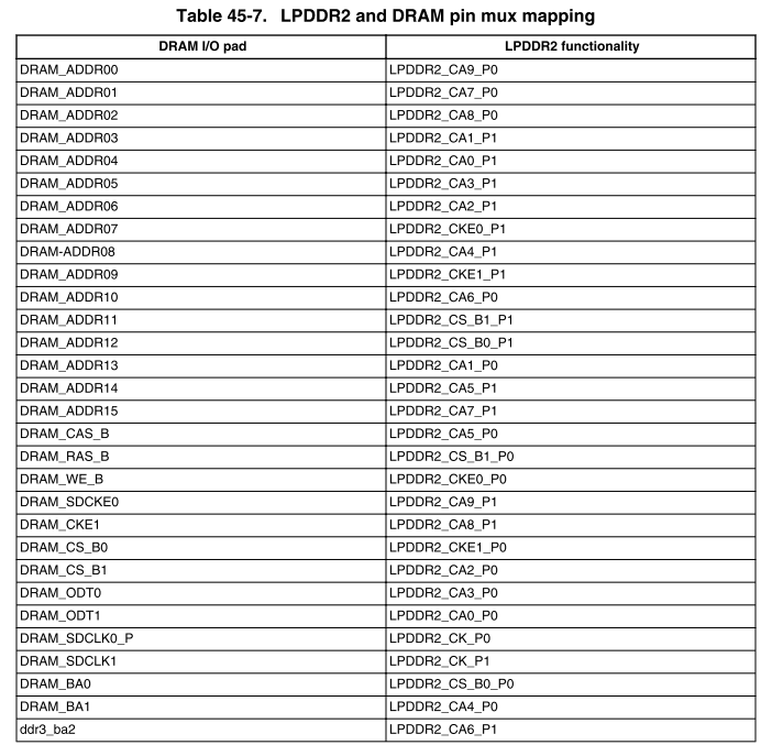

Hi There,
I want to check for IMX7.
I want to connect the IMX7 and LPDDR3.
Do you have a document that describes the pin mapping of LPDDR3 ?
The IMX6, there was pin mapping of LPDDR2.
 Applications Processor Reference Manual -  Multi Mode DDR Controller (MMDC) - LPDDR2 and DRAM pin mux mapping
 - satoshi

Hi, Yuri
Thank you for your reply.
The meaning of "No special mapping",
Is a document the meaning that there is not ?
or
Should I be connected as well as a document?
http://cache.nxp.com/files/nxp/brochure/WARP7-FLYER-V2.pdf?

  You may look at the WARP 7 design, where LPDDR3 with i.MX7 are applied.

Hi, Yuri
Thank you for information and in reference document.
I will do the reference for circuit design.
I use IMX7 Dual.
 Device:「MCIMX7D7DVM10SC」
Do you have a document that describes the pin mapping of LPDDR3 and IMX7 Dual ?
 - satoshi
1,879 Views
Yuri
  No special mapping for LPDDR3 for i.MX7.
