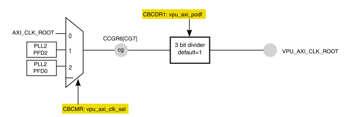

Dear All,
Is it possible to change the VPU Clock source from PLL2_PFD2 to PLL2_PFD0?
My customer doesn't use the PLL2_PFD0 for any other.
Is there some impact?
Device i.MX 6Dual
BSP: jb4.2.2_1.1.0 (L3.0.35)
Keita

usually PLL2_PFD0 is used by LVDS. LVDS clock is not expected to be changed. If there is no any other module which used PLL2_PFD0, VPU clock can be configured to use PLL2_PFD0.
