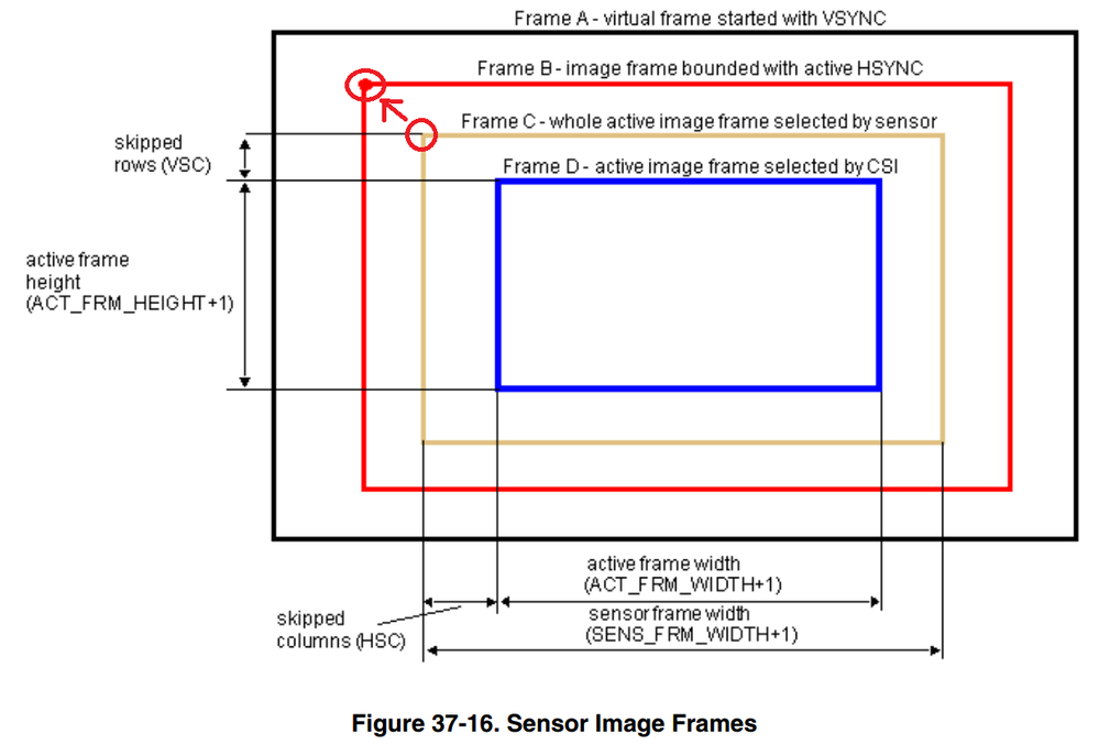

Dear All,
Hello.
Refer to Figure 37-16. Sensor Image Frames in IMX6DQRM(Rev.2).
I think that Frame B and Frame C are same meaning.
What is difference of Frame B and C?
(I couldn't find the skip setting like skipped rows and skipped columns between Frame B and C.)
Keita

Yuri
   Figure 37-16 relates to general considerations, when horizontal line
consist of the following periods :
- back porch ;
- active data ;
- horizontal blank.
  In some sense You are right : for situation when HSYNC is used as DE signal
for active data, back porch and horizontal blank periods are not defined.
Yuri.

Yuri
From the RM : “The virtual frame A starts with the VSYNC
signal. After vertical blanking starts frame B. The HSYNC
signal indicates boundaries of the frame B. The frame B includes
both the active sensor frame C and horizontal blanking intervals”.
  So, difference between frame B and frame C is horizontal blanking
interval.
Yuri

keitanagashima
Senior Contributor I
Dear Yuri,
Hello. Thank you for your reply.
My understanding was HSYNC must set low for horizontal blanking intervals from below community.
https://community.freescale.com/message/483801?et=watches.email.thread#483801
So, I considered that the HSYNC signal indication (frame B) is same as Frame C.
Keita
2,214件の閲覧回数
Yuri
Timings for frames B and C are not the same. This is reflected  in the RM.
Yuri.

keitanagashima
Dear Yuri,
Hello.
Sorry, I couldn't understand why frames B and C are not the same.
"The HSYNC signal indicates boundaries of the frame B."
I consider that the HSYNC signal indicates the active sensor frame C because HSYNC must set low for horizontal blanking intervals.
Keita

keitanagashima
Dear Yuri,
> In some sense You are right : for situation when HSYNC is used as DE signal for active data, back porch and horizontal blank periods are not defined.
OK. Thanks Yuri.
It's my understanding.
- Gated Clock mode (Not use DE signal) --> Frame B = Frame C
- Use Data Enable signal --> Frame B != Frame C
Keita

Yuri
Strictly speaking, the i.MX6 Datasheet(s) does not contain (require) timing specs between
HSYNC, VSYNC and data, therefore  we cannot say exactly if horizontal blank = 0
for the gated mode.
Yuri.

keitanagashima
Hi Yuri,
Let me confirm again.
In case of Gated Clock mode:
I consider that Start point of Frame B is same one of Frame C.
