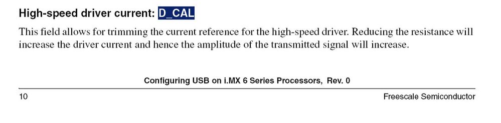

Hello. I have a question about D_CAL and TXCAL45DP/DN in USBPHYx_TXn register.
Refer to attached file.
And, please answer to me.
I referred the below topic. But, I couldn't understand it.
Re: i.MX6 USB drive strength.
Keita

keitanagashima
Senior Contributor I
Dear Igor,
Hello. Thank you for your quick reply.
In case of D_CAL=0000b, 1.19*17.78mA = 21.1582[mA].
But, the it was described Resistor trimming code = 0.16% in RM.
In case of D_CAL=1111b, 0.79*17.78mA = 14.0462[mA].
But, the it was described Resistor trimming code = +25% in RM.
How should I calculate it from RM?
(I didn't understand the relation of your value and RM one.)
Keita
1,188 Views
igorpadykov
HI Keita
these resistors are for trimming the current, as described in AN4589
I do not think that you can calculate it from RM,
I provided you info from AE team (SR-2466611351), one can
just use it.
igor
