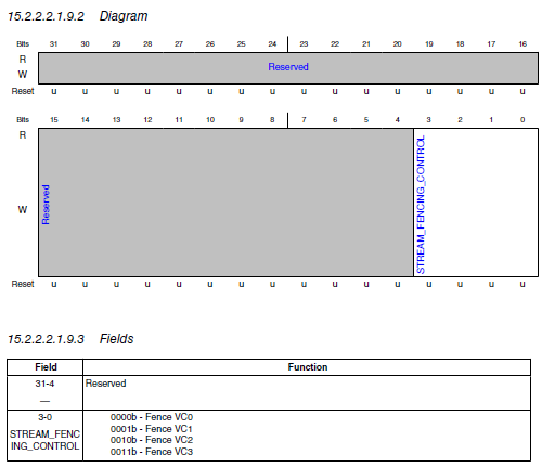

MIPI-CSI2 has STREAM_FENCING_CONTROL register. I have checked following VC enabling patch.
It seems like the STREAM_FENCING_CONTROL register is not using by linux BSP.
Could you please explain me feature of STREAM_FENCING_CONTROL register?
What does "Fence VC0" mean?

The stream_fencing is used to tell the MIPI CSI2 stop data transfer to pixel link.
For example, software can write "Fence VC0" to STREAM_FENCING_CONTROL register, then after MIPI CSI2 stops to transfer VC0 data to pixel link, the status "VC0 is fenced" can be read from STREAM_FENCING_STATUS register.
MIPI CSI2 reset can recover it.
