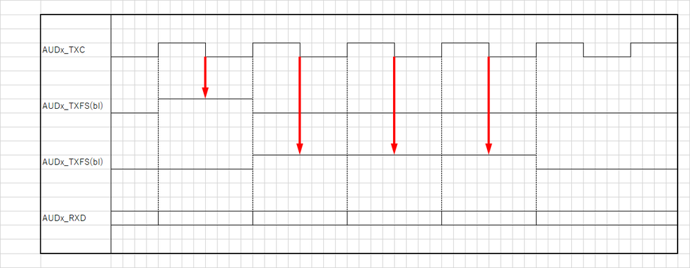

I have a question about fall edge hold timing of FS in slave mode SSI.
In Figure 93. of datasheet IMX6DQPAEC rev3, Hold time of falling edge of AUDx_TXFS are defined
as more than 10ns from AUDx_RXC high to AUDx_TXFS low(SS30 and SS34 of Table 85).
In this time, AUDx_TXFS and AUDx_RXD of Master device are transition by rise edge of AUDx_RXC.
And Slave device will be latched each signals by falling edge of AUDx_RXC.
If so, SS30 and SS34 of Table85, It is difficult to keep 10ns as hold time because it is transition timing.
Is it correct to define SS30 and SS34 as "AUDx_RXC high to AUDx_TXFS  low"?
I think that it should be define as a transition timing like SS28 or SS32 or
a hold time of AUDx_TXFS, it must define from falling edge of AUDx_RXC like a SS41.
I hope I can hear from you soon.
Ishii.

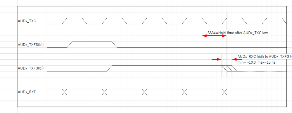

>in Figure 93. of datasheet IMX6DQPAEC rev3, Hold time of falling edge of AUDx_TXFS are defined
>as more than 10ns from AUDx_RXC high to AUDx_TXFS low(SS30 and SS34 of Table 85)...
>.. think that it should be define as a transition timing like SS28 or SS32
regarding your notes you are right, SS30 and SS34 timings should be depicted
as transition timing like SS28 or SS32.
igor

Hello Igor,
Thank you for your quick response.
Before update datasheet, is it ok to design SS30 and SS34 specification are not 10ns(min),
but same as SS28 and SS32(min=-10ns, max=15ns)?
Ishii.
1,686 Views
igorpadykov
Hi Ishii
I think yes.
igor
