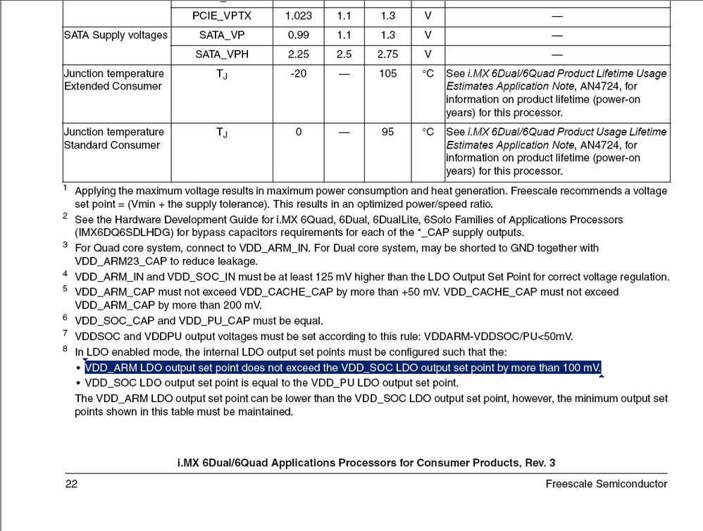

Refer to the 4.2.1 Power-Up Sequence in i.MX6SDL data sheet (IMX6SDLCEC Rev.4).
There is below limitation.
— VDD_ARM_CAP must not exceed VDD_SOC_CAP by more than +100 mV.
But, i.MX6DQ data sheet doesn't describe this limitation.
Is it possible to ignore this limitation for i.MX6DQ?

this is described in IMX6DQCEC  p.22

Thank you for your quick answer.
OK. I got it.
