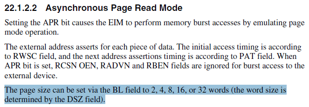

yuuki
Senior Contributor II
art
Dear Artur-san,
Thank you for your support.
I was able to understand it.
The following is explained in "22.1.2.2 Asynchronous Page Read Mode" of Reference Manual.
I understood that this explanation was a mistake.
Yuuki
1,481件の閲覧回数
art
Sorry, my previous explanation was wrong, just mixed up some field names. Actually, in both Page Access mode and Synchronous mode, the burst length is defined by the BL field value (so, there is no bug in the Reference Manual document), and the PSZ field defines the page size of an external memory device in Synchronous mode to define whether the synchronous burst crosses the page boundary and the burst should be re-generated.
Anyway, the PSZ value does not affect an asynchronous access.
