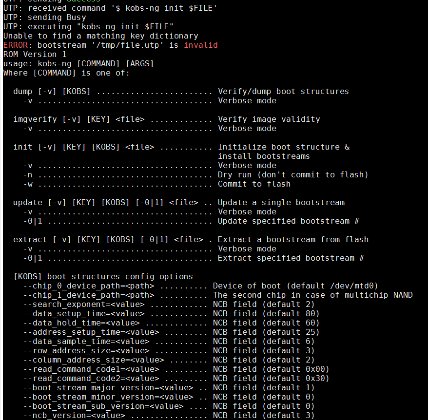

I am like below step to step to opreation:
     1. According Programming_OTP_Bits.pdf file use keygen tool create new key
                         ./keygen customkey.txt
     2. Copy the customkey.txt key file to firmware project folder, and create new updater_ivt.sb and imx_linux_ivt.sb files
                         elftosb -k customkey.txt -f imx28 -c ./updater_ivt_kone.bd -o updater_ivt_kone.sb
                         elftosb -k customkey.txt -f imx28 -c  ./linux_ivt_kone.bd -o imx28_ivt_kone_linux.sb
     3. According Programming_OTP_Bits.pdf file create bit_setting.txt for imx28, the content like below:
                         *chip-family-mx28*
                         lock_rom0 = true
                         lock_cryptodcp = true
                         lock_cryptodcp_alt = true
     4.According Programming_OTP_Bits.pdf file create OtpInit.sb file
                         ./otp_burner.py -i kone_bit_settings.txt -k customkey.txt  --srk SRK_1_2_3_4_fuse.bin
     5.Copy OtpInit.sb file to BitInit_2.2 folder, and use BitInit.exe tool burn the OtpInit.sb file
                         At windows 7 cmd execute BitInit.exe to burn
     6.Copy updater_ivt_kone.sb and imx28_ivt_kone_linux.sb to Mfgtool profile folder
                         Use Mfgtool programming *sb files
     7.Get like below error code:
I am trying to modify Mfgtool ucl.xml config file, at kobs-ng cmd add -k option and keygen tool create of customer.txt hex string, but get invalid key error
I don't know is my operation step has some question or is bit_setting.txt config has error e.g. some bit not burn or other.......
Thnaks.

oh, has any friends reply, Myself reply this question, I am modify the kobs-ng source code, at src/main.c file init_main function, modify the args parameter parsing code. I don't know why kobs-ng can't parsing -k option HEX String and I can't sure modify the kobs-ng code is a best methods, but it's solve my question.

Hi bruce
regarding kobs-ng one can try more new versions, like imx-kobs-5.4
www.nxp.com/lgfiles/NMG/MAD/YOCTO/imx-kobs-5.4.tar.gz
