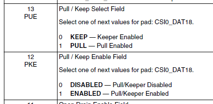

Q2:
For Pad Control Register(e.g. IOMUXC_SW_PAD_CTL_PAD_CSI0_DATA18),what does Keeper Enabled mean?
What is Keeper?

1. output also can be configured with pull-up resister
2. keeper functionality is explained on
Bus-holder - Wikipedia, the free encyclopedia
igor

So there is no relationship between pull-up and the direction of pad.Right?
ZongbiaoLiao
1,269 Views
igorpadykov
yes right
