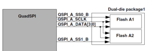

I am using QSPI_A to access memory.
Since the QSPI_A_SS0_B and QSPI_A_SS1_B signals are Chip select1 port0/1 deviceA, shouldn't CS1 on Port A be set to enable?
The designer says that CS1 on Port A can be accessed with the disable setting.
Is there any problem with this setting?
Goto

   QSPI_A_SS0_B may be used without QSPI_A_SS1_B.
Section 10.2.8.2 (Dual Die Flashes) of i.MX 7Dual Reference
Manual (Rev. 1, 01/2018) describes configuration, where
both signals are applied.

Is the QSPI_A_SS0_B(QSPI_A_SS1_B) signal valid when the CS1 on Port A setting in Table 6-50 (QuadSPI configuration parameters) is disabled?

  The QSPI_A_SS0_B signal is valid when the CS1 on Port A setting in QuadSPI configuration parameters is disabled. QSPI_A_SS1_B is not configured for QSPI in such case.

When the setting value of "CS1 on Port A" in Table 6-50 (QuadSPI configuration parameters) is disabled, is it not possible to use Flash A2 with the following configuration?

 if "CS1 on Port A" in  QuadSPI configuration parameters is disabled,
it is not possible to use the Flash A2.

If the setting value of "CS1 on Port A" in Table 6-50 (QuadSPI configuration parameters) is enable, can Flash A2 with the following configuration be used?

  yes.
