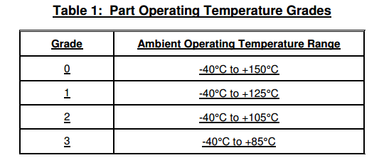

gusarambula
Hello Keita Nagashima,
Thanks for your patience.
Finally, just for reference the temperature grades for AEC-Q100 qualification are as follow:
Grade 0: -40°C to +150°C ambient operating temperature range
Grade 1: -40°C to +125°C ambient operating temperature range
Grade 2: -40°C to +105°C ambient operating temperature range
Grade 3: -40°C to +85°C ambient operating temperature range
Grade 4: 0°C to +70°C ambient operating temperature range

keitanagashima
Senior Contributor I
Hi gusarambula,
> I confirmed and the i.MX6SX Automotive parts can reach -40C to +125C, which is AEC-Q100 Grade 1.
> The same for our i.MX6S/DL/D/Q Automotive parts (I'm sorry for the incorrect information earlier).
Really?
i.MX6SX  is defined at the junction temperature (-40C to +125C).
But, AEC-Q100 grade is defined at the ambient temperature!
I think that Junction temperature and Ambient one should have temperature difference.
Please check again.
