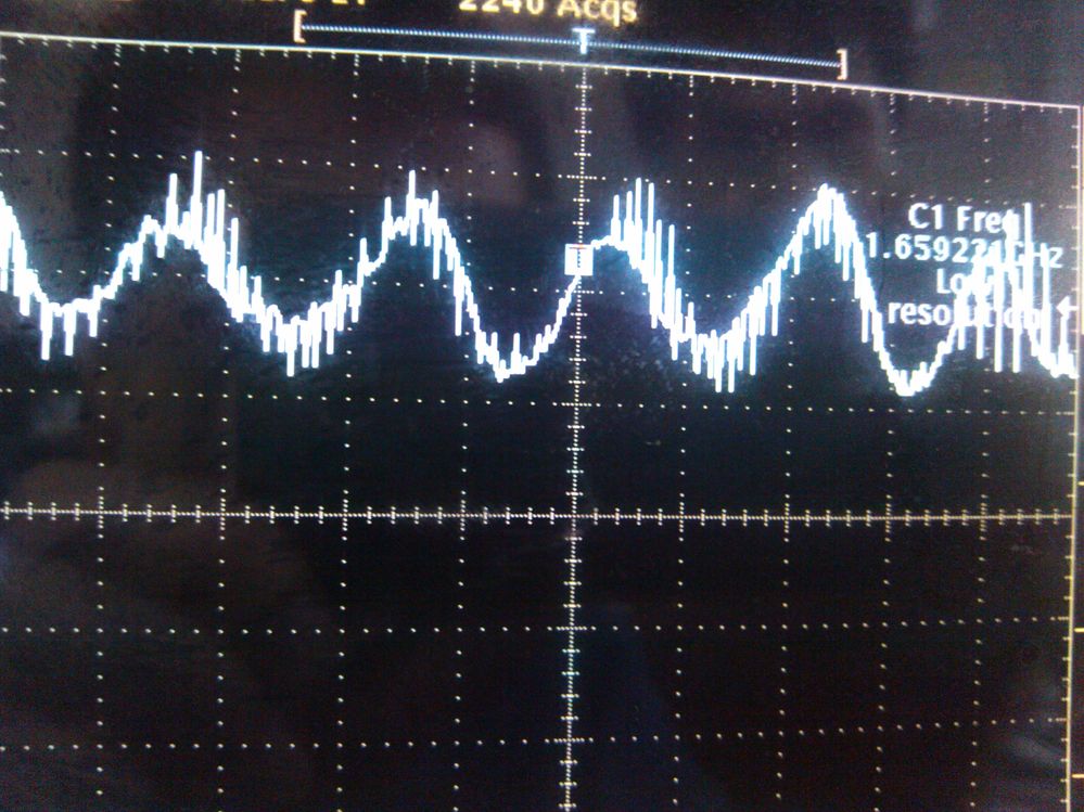

RobbieJiang
Hi Qiang,
Still back to this issue after 3 months.
Currently I'm working with Mx6q_sabrelite  and the latest BSP Ltib3.0.25_4.1.0.
And I would like to get 1280x1024@60Hz DVI output from ADV7513, which is connected to MX6Q LCD display port.
However, we can not get any output on our DVI display.
After checking the PIXCLK of the LCD port ( which is output by MX6Q processor ),
we found that the wave form of the PIXCLK signal is distorted ( As shown in enclose distored_pixclk.jpg).
Because of the incorrect wave form, adv7513 internal PLL circuit can not lock to this pix clock,
and naturally no output on the DVI display.
The fb_videomode for 1280x1024@60Hz in lcdif_modedb[], mxc_lcdif.c, is as follows:
{ "1280x1024@60", 60, 1280, 1024, 9259, 248, 48, 38, 1, 112, 3,
FB_SYNC_HOR_HIGH_ACT | FB_SYNC_VERT_HIGH_ACT,
FB_VMODE_NONINTERLACED, FB_MODE_IS_VESA,

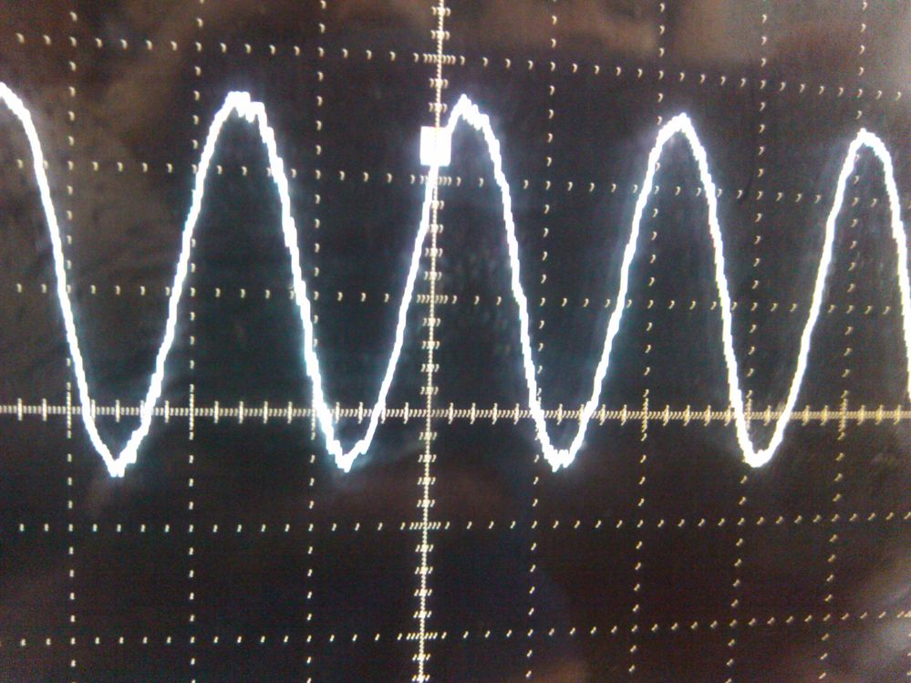

However, if we change the LCD interface configuration to 1400x900@60Hz,
we can get a perfect PIXCLK output from MX6Q LCD interface.
The waveform of PIXCLK with 1400x900@60Hz can be found in attached perfect_pixclk.jpg.
And therefore everything goes well.
The fb_videomode for 1400x900@60Hz in lcdif_modedb[], mxc_lcdif.c  is as follows:
     {   "1400x900", 60, 1440, 900, 9389, 232, 80, 25,  3, 152, 6,
         0, FB_VMODE_NONINTERLACED, FB_MODE_IS_VESA,
From the measured wave form, it seems that there is something wrong
with the pixclk generation for LCD interface in 1280x1024@60Hz mode.
Is this problem perhaps related to the issue mentioned by previous
I mean, related to the system clock tree?
Any idea?
By the way, is there any Linux command to check the system clock tree?
Jie
4,827 Views
admin
Specialist II
Hi Robbie,
Drive strength and slew rate may affect the PIXCLK wave form. Suitable configuration of PIXCLK drive strength and slew rate may solve the 1280x1024@60Hz mode distortion.
4,827 Views

RobbieJiang
Hi Qiang,
Thanks for your reply.
After checking the code,I'm sure ".int_clk = false" holds.
And now I have only ONE display device on the LCD interface, the HDMI and other LVDS display devices have been disabled.
From the measurement, we can see he PIXCLK wave form varies a lot with different resolution and timing configuration,
as you have seen from the attached files. Seems that PIXCLK signal with lower freq has better form.
My question is, with the same clock source, why is the wave form is much worse with 1280x1024@60Hz than 1400x900@60Hz?
By the way, after changing the SPPED field to 200Mhz and DSE field to 48Ohm,
we can get output on the LCD display, which is output by ADV7513 on MX6Q's LCD interface.
The default DSE is configured for 120Ohm. With these changes, ADV7513 internal PLL can lock the PIXCLK signal,
even the wave form is still not satisfied.
However, our customer has a special display device with strict timing requirement.
The same setting( 1280x1024@60H, which works on LCD display ),  still does not work on it,
I mean, there IS output on the device, but it looks bad.
I'm afraid this bad PIXCLK wave form is related to the incorrect timing on our customer's device.
Any idea?
Jie
