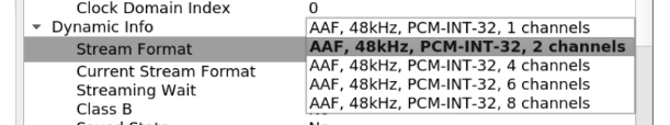

jpa
Hi, Joseph,
Thanks for responding.  Have you tried what you're suggesting?  When I run the Hive controller, I can see the configurations, and the Dynamic Info->Stream Format, but I cannot change the stream format.  The only selection offered is the one that is set.  For demo #22, that's AAF, 48kHz, PCM-INT-32, 2 channels.  I was hoping to configure a profile as having an 8 channel stream, rather than 4 streams of 2 channels (or, in the case of profile #22, 2 streams of 2 channels).
Having said that, I have been able to configure ALSA's plug-ins to divide my 8 channel device into 4 2-channel devices, and they work, at least with aplay and arecord.  When I use one of the pairs as the alsa device for this demo (#22 or #9/11), I get no errors that I recognize, but also no sound.  More precisely, I get no sound that is related to the signal being put into the alsa device.  When I make the connection in the Hive controller, I DO hear a faint high-pitched noise, so it's trying to do something.
I've attached the /var/log/avb and /var/log/avb_media_app logs from the talker and listener in case someone can see something I cannot.
1,202 次查看
jpa
Well, I think I can answer that last piece, myself, at this point.  The Hive controller does not allow me to change the configurations.  There are drop-downs that make it seem like it might, but the drop-downs are only populated with the current setting.
