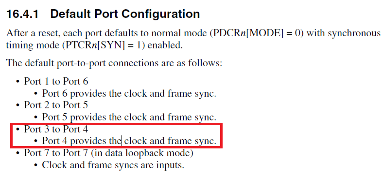

Hi all
In the IMX6DQRM document this section explanation port to port relationship,
the red color box meaning is port 3 can connect to port 4, it is correct or not ?
Please help me clarify this issue, thanks.

Hi Felix

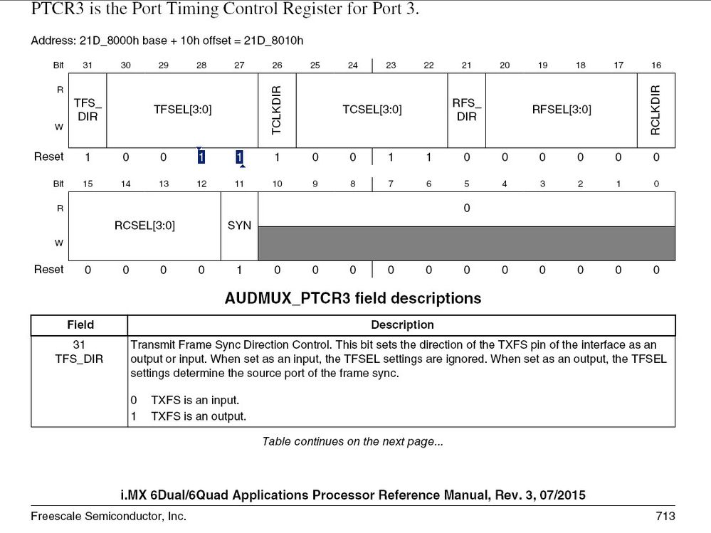

description is correct also please refer to RM in
sect.16.6.5 Port Timing Control Register 3 (AUDMUX_PTCR3) :
TFSEL=3, TCSEL=3
igor
