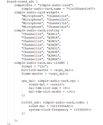

I'm trying to interface a  TLV320ADC6140 audio ADC (EVB) to imx8mm SOM, running Linux 5.4.85, but without success .... always get the same ASOC error  :
asoc-simple-card: probe of board-sound_adc failed with error -22
What have I done :
- Include driver & enable it in the kernel config

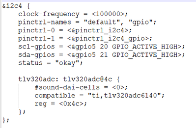

- In the driver device tree bindings there is only I2C example :
  After implementing it, I can see that the .ko loaded correctly, and the I2C bus works.

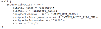

- I've enabled in device tree SAI2 + pinctl muxing and declared simple-audio-card in order to be recognized by ALSA.
Relevant captures from my device tree :
Below are the relevant PINs we plan to use ( At the end , I'll add also Audio DAC ).
Below:
- using TDM ( in order to support 2 ADC on the same bus)
- As far as I understand the SAI is the master, so BCLK and FSYNC from CPU.
Please advise what can be the problem.
Thanks in advanced.
Moran.

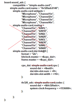

Ok, update.
After debugging with printk the /sound/soc/generic/simple_card.c, I successfully moved one big step forward: the ASOC recognized my "simple-audio-card" and now it can be found as card# in /proc/asound/.
What was wrong :
- Remove the prefix before the dai-link CODEC & CPU
- Remove the widget - was wrong in front mt ADC driver
Now I can move to the next step: probe out the SAI2 signals to the scope.
Thanks.
Moran

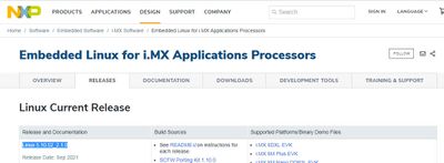

What is the latest recommended Linux version by NXP?
Thanks in advance,
Moran.
5,070 Views
igorpadykov
https://www.nxp.com/design/software/embedded-software/i-mx-software/embedded-linux-for-i-mx-applicat...
igor
