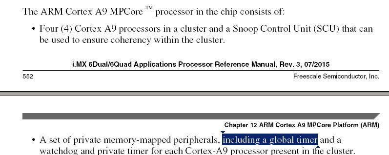

By Cortex ™ -A9 MPCore Technical Reference Manual, the global timer is clocked by PERIPHCLK. I don't know which clock is it in  iMX6QSD CCM Clock Tree.
By my test  the clock frequency of ARM global timer is changed when I change ARM clock frequency for DVFS. So I guess the clock of the global timer may be ARM_CLK_ROOT. Is it correct?
What is the clock frequency of ARM global timer?

Thanks. How about the clock frequency of the global timer. From Cortex ™ -A9 MPCore Technical Reference Manual,
        The Interrupt Controller, global timer, private timers, and watchdog are clocked with PERIPHCLK.
        PERIPHCLK must be synchronous with CLK, and the PERIPHCLK clock period, N, must be configured as a multiple of the CLK clock
        period. This multiple N must be equal to, or greater than two.
So the clock frequency should 1/N of ARM_CLK_ROOT clock. How much is the N on iMX6QSD? By my testing, it should be 2. Is any register there to set N?

Hi Miles
you are right,
the mpcore timer runs at half the CPU frequency.
there are many references to that, like
freebsd/mpcore_timer.c at master · freebsd/freebsd · GitHub
though I could not find this in documentation, probably you can post
this to Support - ARM
