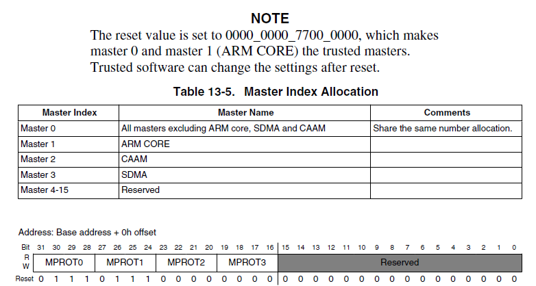

2. AIPSTZx_MPR
     As bellow description, I need to control AIPSTZx_MPR register.
     and i could see something wonder.
     I think i could write only AIPSTZx_MPR(0x0207_C000) to control MOROT0, MOROT1, MOROT2, MOROT3
     But in the u-boot source code, it write 0x0207_C000 and 0x0207_C004 to control MOROT0, MOROT1 as bellow.
     It's different with the reference menual.
     then I should write 0x0207_C008,0x0207_C00C to control MOROT2, MOROT3?
     Please give some guide in detailed as possible.

2.
  U-boot is based on preliminary i.MX6 specs, where master’s bit fields 4-15 (MPROT4-15)
were not declared as Reserved. Please follow the recent RM.
