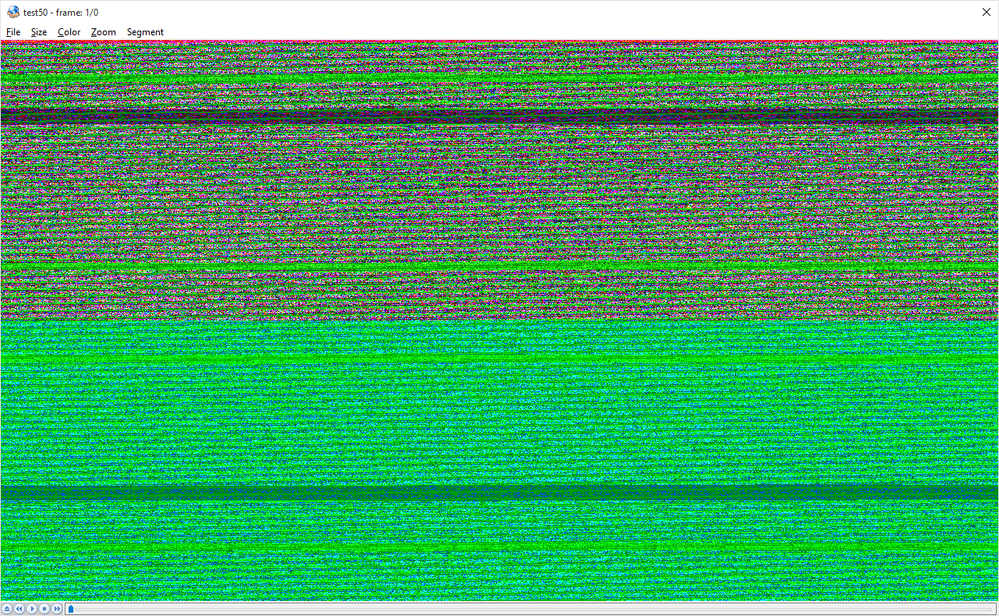

jamiew
Thanks Qiang I'll look at drive strength options.
I can't use the mxc_v4l2_tvin test as I don't have a display. The final application will stream over ethernet.
In the meantime I've changed mxc_v4l2_capture.c:-
if (ifparm.if_type == V4L2_IF_TYPE_BT1120_PROGRESSIVE_SDR) {
// code as it was csi_param.data_width = IPU_CSI_DATA_WIDTH_8;
  csi_param.data_width = IPU_CSI_DATA_WIDTH_16;.....
Which has made a difference to the output (which I save to disk as raw bytes captured by v4l and then download via SCP):-
     (crop magnified x4)
6,614件の閲覧回数
qiang_li-mpu_se
Hi Jamie, for BT1120 interface, you should not set IPU_CSI_DATA_WIDTH_16, it is wrong.
By the way, since you had used ethernet to transfer the data, did you encode it? I think you should use mxc_v4l2_tvin.c to test it, you can modify the code and let it save th captured video into file directly. The tvin test application will capture the raw image dirctly, then you can know if the data is correct or not.
For encoding, it needs YUV420 format data, so if the input is UYVY, you need convert it to YUV420, then encode it. If you used the UYVY data for encoding, the image will be wrong.
6,614件の閲覧回数
jamiew
Hi Qiang
After looking at the binary data captured it seems there are SAV and EAV codes in it. There are FF 00 00 67 and FF 00 00 20 at regular intervals. However they are only 1284 bytes apart. So for 1280 wide 16bit data this seems far too small. Also should the codes not have been stripped out with the non active video area by the IPU before the data gets to V4L?
Jamie
6,614件の閲覧回数
qiang_li-mpu_se
You can use internal vsync mode to skip the EAV/SAV:
In your adv7441a.c:
p->u.bt656.bt_sync_correct = 0; // use internal VSYNC
