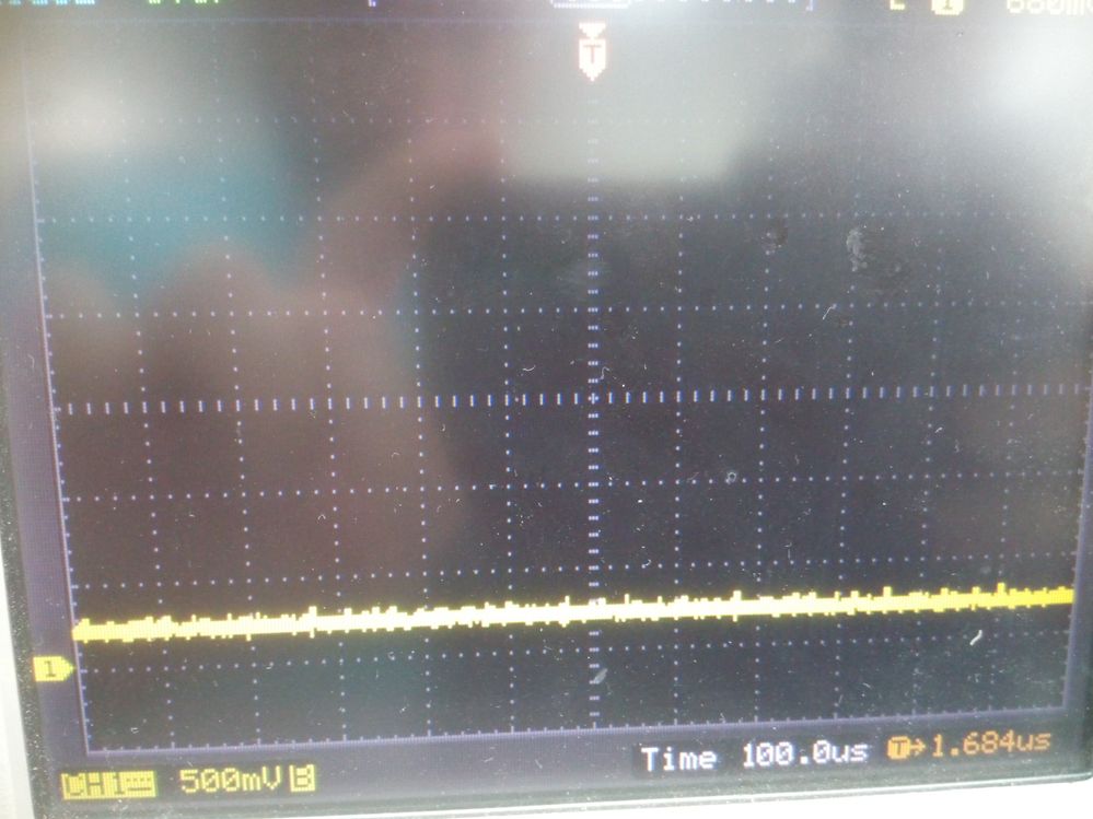

Hello.
Currently I am working on driver integration task for adv7280-m chip.
And I got issue related to mipi csi clock. Mipi dphy driver detect Clock line as ULPS(ultralow power state).  You can see my oscilloscope images in this branch adv7280-M clock problem | EngineerZone .
I am trying to understand what could be the reason of issue: adv7280-m chip or imx6. Could anybody, who  worked with this adv7280-m chip show me your signals on the mipi lines or analize my signals.
I also interested in what should be switched on first: the decoder chip mipi dphy or  imx6 mipi dphy.
As I understand. there are a lot of people who managed to get workable adv7280-m chip with imx6. Could you also share your mipi csi2 driver settup
Thanks.

Do you think it is correct that transition from 1.2V to 0.1-0,2V on CLK line was detected as ULPS by imx6(0x210 in state register)?
Thanks.
6,590件の閲覧回数
igorpadykov
I think yes it can be detected in MIPI_CSI_PHY_STATE register bit 9.
igor
6,590件の閲覧回数
kurkinalexandr
But ULPS mode should have 0V level on lines. In our case we have 0,1-0,2V and it is high speed level according to DPHY specification.
6,590件の閲覧回数
igorpadykov
are you sure that this is not noise, as is ULPS mode
sensor can turn off supplies from lane.
Also this can be quality issue, so recommended to double
check behaviour on other board/sensor.
6,590件の閲覧回数
kurkinalexandr
As I understand, imx6 should detect 1.2 >0.1V transition(low power -> high speed) and set termination on the line. If  it detect this transition as ULPS, it of course will not set termination and future signal on the line will be not correct(noise in my case as you said).

kurkinalexandr
I of course tried all of these debug steps.
See below my oscilloscope images.
1) Low state mode: CSITX_PWRDN bit (Address 0x00, Bit 7) contains 1 value.
Mipi data:
Mipi clk:
2) Switching on to high speed mode: set CSITX_PWRDN bit (Address 0x00, Bit 7) in zero value.
Mipi data in high speed mode:
Mipi clk in high speed mode:
Transient process from low power to high speed on mipi clk line:
If I switch on imx6 dphy(mipi_csi2_reset()) after clearing CSITX_PWRDN in ad7280-m, I get 0x200 in State register. If I switch on imx6 dphy before clearing CSITX_PWRDN, I get 0x210 in State register.
3) Just for experience: set both lines to ULPS mode, regarding to ADV7280_7281_7282_UG-637.pdf documet P.52
For both lines:
You can see, that MIPI lines pulled down in real ULPS mode.
I also looked through this brunch i.MX6Q video capture issue with ADV7280-M.
But I think my problem is a little be different, as I can`t see clk sygnal physically. There could be several reasons for this issue:
1) imx6 incorrect terminates mipi clk line. To exclude this version, It could be useful if anybody could show his mipi clk sygnal in case of switched off imx6 dphy and switched on dphy.
2) ad7280 incorrect pass clk sygnal. To exclude this issue I need to get example of clean mipi sygnal  from ADV7280-m with disconnected from mipi slave device wires.
3) hardware issue on my board
Than you for help.
