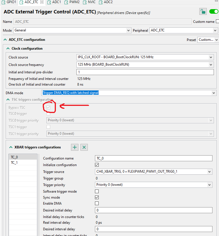

I am trying to trigger ADC1 and ADC2 conversions at the same time, syncronised to a PWM channel using val4.
It works with ADC1, but I cannot get ADC_EXT to trigger ADC2. The conversion complete interrupt is never called for ADC2. Nothing I do can get ADC2 to trigger.
In fact as soon as I enable Sync Mode, everything stops working and even ADC1 stops updating. Something very strange is going on.
Can someone please take a look at my project and see if I am doing something wrong? I have attached full project for rt1024-evk.
I have looked at all the examples in the sdk and application notes but I can't see anything wrong. Maybe there is a silicon bug?

niabLEYW
Hi Jeremy
Thanks for your reply.
I already looked at that thread and I can't see anything I am doing wrong.
I am using Trigger group 0 for ADC1 and Trigger group 4 for ADC2. ADC1 works but ADC2 does not work. None of the sdk examples use ADC2. Has anybody actually tried it?
Can you please take a look at my example project and see if you see anything wrong?
I have attached my peripherals.c here again.

niabLEYW
Ok, after a whole day trying to make it work I finally discovered the problem.
To use ADC2, you cannot have the .enableTSCBypass option set. It must be cleared. This is definitely *not* made obvious in the manual.
The autogenerator GUI sets this option and greys it out so it cannot be changed. Why? The only way I can make it work is to clear it manually.
Thanks.

jeremyzhou
Please install the updated MCUXpresso Config Tools which allows setting TSC triggers configuration.
