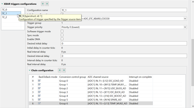

I have a custom board with iMX RT 1062 XVN5B, i want to measure 15 ADC channels separate in 2 groups :
Group 1 : 8 channels ADC1.1 to ADC1.8,   trigged by CH0_XBAR_TRIG, 0 » PIT_TRIGGER0  (100 uSec)
Group 2 : 7 channels ADC1.9 to ADC1.15,   trigged by CH0_XBAR_TRIG, 1 » ADC_ETC_XBAR0_COCO0
I use the config tools like this :
ADC1 : 15 channels
ADC_ETC XBAR trigger TC0
ADC_ETC XBAR trigger TC1
PIT trig 0
ADC_ETC pin mux
ADC1 pin mux
When i read the ADC_ETC_TRIG _0  results « ADC_ETC_GetADCConversionValue(ADC_ETC, ADC_ETC_TC_0, 0 to 7) »  corresponding to (ADC channel 1 to i get correct values.
When i read the ADC_ETC_TRIG _1  results « ADC_ETC_GetADCConversionValue(ADC_ETC, ADC_ETC_TC_1, 0 to 7) » corresponding to (ADC channel 9 to 15)  i get nothing.
I am looking for a solution to read the 16 channels of ADC1
