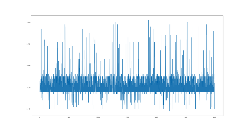

We get very strange results:
Exactly the same configuration of the ADCs is used in both cases. Noise of about 25bits is introduced and its noteworthy that it is only in positive direction. In both cases we sample VDDA_ADC_3P3/2 at the input, generated directly from VDDA_ADC_3P3 with a voltage divider. VDDA_ADC_3P3 is decoupled with one 220nF and one 1uF capacitor very close the pin. VDDA_ADC_3P3 is shorted with MCU_DCDC_IN as suggested from the reference design. We experience the same issue if we sample GND.

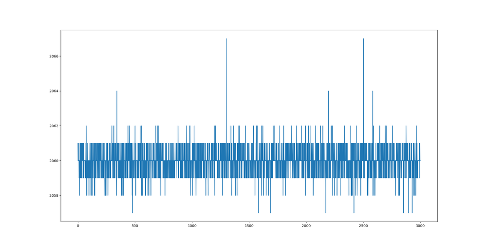

We found the problem to be resolved if we use the IPG clock instead of the asynchronous one. More specifically we added these two lines of code:
k_adcConfig.clockSource = kADC_ClockSourceIPG;
k_adcConfig.clockDriver = kADC_ClockDriver4;
This led to the following performance of the ADC on the evaluation board with the supplied sample project
This is the noise we would expect on the MIMXRT1060-EVK with the reference voltage supplied directly from the buck converter. On our custom hardware we achieved the same performance in SyncMode as in serial mode as you can see above in the first picture (+/- 2bits and some outliers). We are still wondering what causes this issue since we have not read about this requirement of not using the asynchronous clock in SyncMode anywhere.

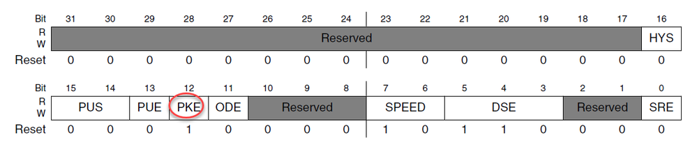

Please check the ADC input pin related PAD Control register [PKE] bit to be 0b0 (disable Pull/Keeper).
Thanks for the attention.

af1
Hi Mike,
Thank you for your answer.
This bit was already set correctly from the PinMux tool. I just verified that this line was present in the pin_mux.c file:

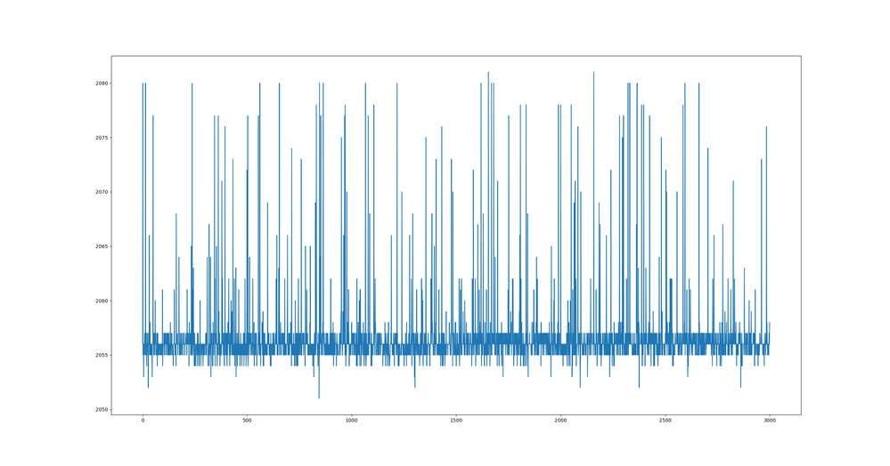

The problem also exists on the MIMXRT1060-EVK evaluation board. I attached a small sample program based on the "adc_etc_hardware_trigger_conv" example from the SDK. In the attached program PIN J23-1 is sampled which should be connected to half the reference voltage (with a simple voltage divider) that we get from J24-7 and J24-8. We write the ADC Values to the array "adc_values" which we extract through the memory browser after a few seconds after starting the program (we simply halt the program with a breakpoint). The adc_values can then be viewed with the file byteplotter.py which is present in the attached folder as well.
On the evaluation board we then get this result:
Again we see a significant noise in positive direction (and some kind of capping in negative direction?).
