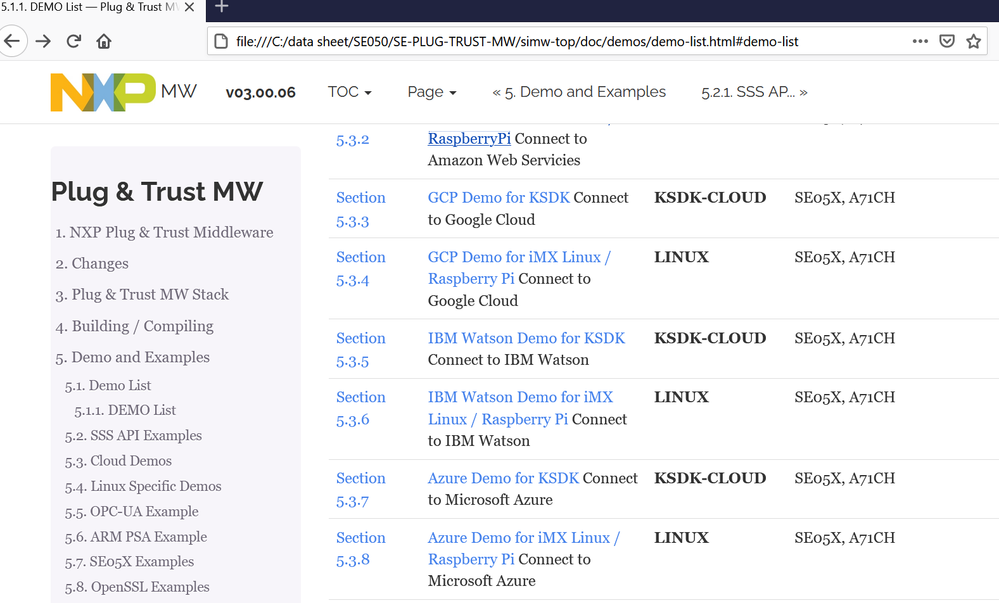

Kan_Li
Hello @jose_au_zone ,
The latest MW for SE050 also support A71CH as well as i.MX 8MQuad, please kindly refer to the following for details.
You may have the MW from the following link:
https://www.nxp.com/products/security-and-authentication/authentication/edgelock-se050-plug-trust-se...
Hope that helps,
Kan
