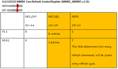

changbaoma
Hi, @igorpadykov
Maybe i have found the root cause. I use the new version v1.1 DDR config tool(https://community.nxp.com/t5/i-MX-Processors-Knowledge-Base/i-MX6UL-ULL-ULZ-DRAM-Register-Programmin... ) to create DDR3 parameters instand of the old version v0.01(https://community.nxp.com/t5/i-MX-Processors-Knowledge-Base/i-MX6ULL-DDR3-Script-Aid/ta-p/1127297). Now with the new DDR3 parameters, i can't reproduce the strange hang.
The main difference of those two DDR3 parameters above is DDR refresh rate, as follow:
I don't know how this difference cause the strange hang.
