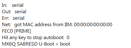

Hello all,
          my board was designed according to the freescale i.MX6Q-SDB's layout ,it has been  downloaded the android jb4.3_1.1.0 system.But it come across the problem,the uboot can start,but the system can't startup. the starting log as follow:

Net:   got MAC address from IIM: 00:00:00:00:00:00
FEC0 [PRIME]
Hit any key to stop autoboot:  0
MX6Q SABRESD U-Boot > boot

mc_pfuze 1-0008: recv failed!:-5,0
mc_pfuze: probe of 1-0008 failed with error -1

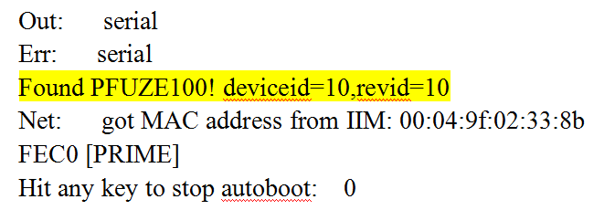

pengxingwei
      For my log,there is no PFUZE100 messages,
,but at freescale board,there has it
it seems the pfuse hasn't work or the i2c has problem,and platform matching about pfuse maybe need to modfy,if it need to modfy,what should I do for it ?
