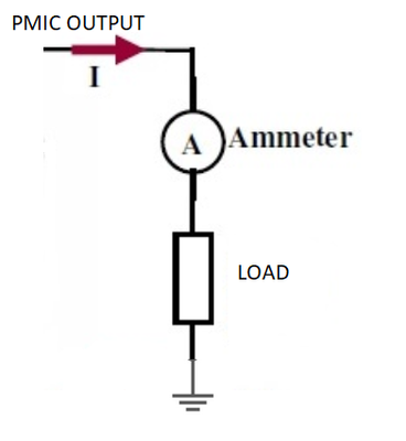

3.5 Measuring points on the EVK platform
To measure the power consumption, do the rework first. Split the connection between the PMIC output inductor and the CPU and connect the NXP power consumption test tool in series. The power data is sampled by the tool and calculates the average current and power consumption.
We do the measure directly with the multimeter.
Could you try doing the measure in the same way, please?

Chavira
Hi @SharmaS !
We do the measurement like the schematic attached, probably adding the resistors could be wrong in this measurement.
Please try to do the measurements like the Application Note and if the problem persists let me know.
Best Regards!
