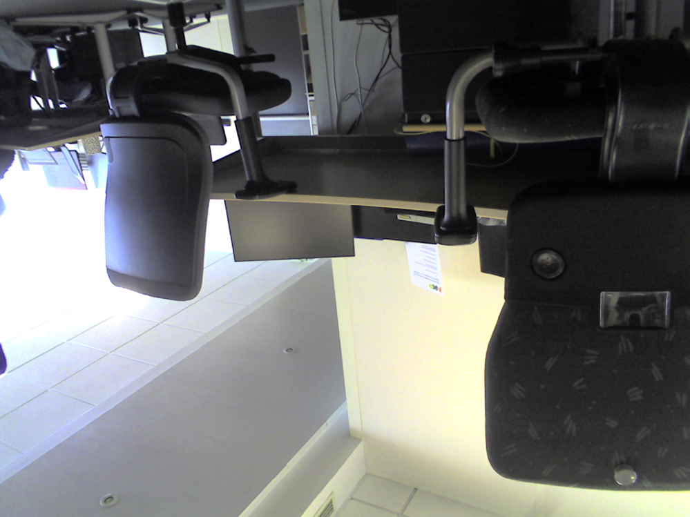

But when using a an USB Camera (/dev/video1) I can reproduce the problem
with imxvideoconvert_g2d
videoconvert:
Is that what you are seeing?
This seems related to usb camera handling. I might have to create a ticket to R&D

frankba
Yes Julien, thats exact what I'm observing here. Thx Frank
