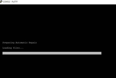

In NXP web side, we try the 5.10.52_2.1.0 Demo Image can not boot up on imx8mq evk Demo board.
Do you have any advice?
The log message will be show " Preparing Automatic Repair Loading files..." in Debug message.

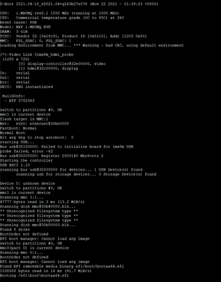

How about the boot command line setting when u-boot boot up.  I will try it on my board and then tell you the result.
1,118 Views
charleshuang
Senior Contributor II
Hi NXP Team
I used the demo image and flash to SD card.
Then I  try to boot form SD in Demo board.
Uboot command :
 #env default -a
 #save
1,112 Views

Hi NXP Team
I  try the 5.10.72 demo Image , the result is the same with 5.10.52.
When the debug port show " Booting /efi\boot\bootaa64.efi"
Then system will be show " Preparing Automatic Repair"
                                          "Loading files...."
Then system hung up.

Rita_Wang
Did the u-boot boot up?
1,126 Views
charleshuang
Hi NXP
Yes,  it's already boot up u-boot.
Do you have the imx8mq evk demo board? You can try it, then you will be know it.
