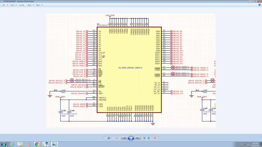

irfansaiyed
Hi @Tamilarasan/@Chris/@NXP
I'm also planning on using 4 x MT41K512M16(Single Die)  to achieve 4GB on my design.
I think I don't need to use  L1 , L9,  J1  and J9 as per below attached image just replace the part as I am using single Die Part MT41K512M16 16-bit.
What you guys say ??
