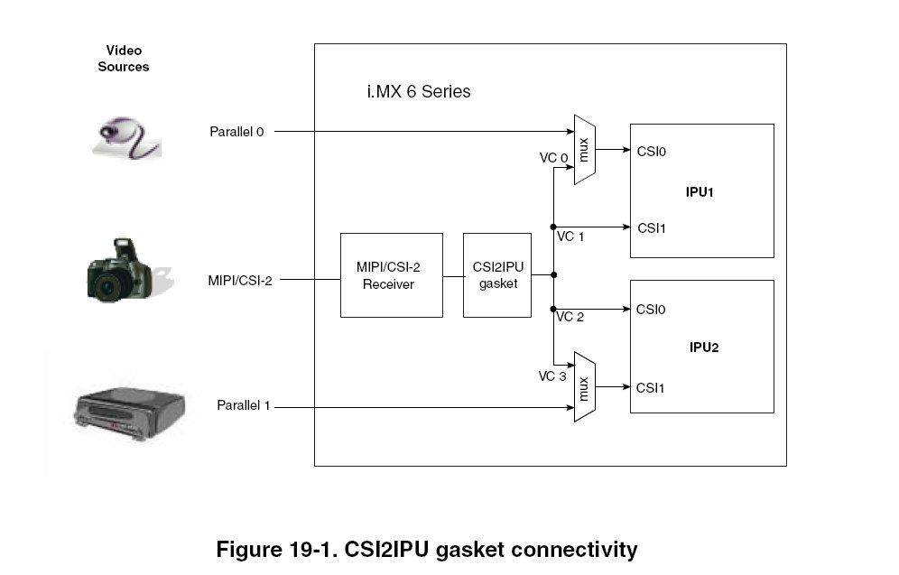

For one of the upcoming products, we are looking for right architecture to implement SVM (Surround view monitoring) system. There will be 4 cameras mounted on car's front, rear, left and right side and we want to design a host system which can capture 4 channel Bayer/YUV data (each 720P@30), stitch them together to create one 720P view to be displayed on dashboard.
Can you suggest Freescale SoC which is able to capture 4 simultaneous channel 720P@30 fps?
If I am not wrong, one i.mx6 can capture two 720P30 channels at max. What if I want to capture 4 channels (I am fine using either CSI/paralle/both interfaces to achieve this use case).
If single SoC can't do that, what are the possible ways to achieve this use case?

i.MX6DQ has 2 IPU, each has 2 CSI parallel intefaces.
Below presentation gives brief description
A Deep Dive into Image Processing for i.MX 6 Series Applications Processors
Performance is given in IMX6DQRM 37.1.2.1.1 Camera Ports:
for parallel interface, the maximum speed of the interface is 240Mhz.
for MIPI for 4 data lanes configuration : 400MByte/sec
So only 2 cameras 720P@30 fps can be connected to 2 parallel CSI intefaces.
For MIPI, one will have to design fpga and multiplex four streams in one stream
with 400MByte/sec /4 = 100MByte/sec bandwidth available per one camera.
So for example with camera YUV422/16 bit/pixel, 720P30~ 30Mpix/sec-->
60MB/sec seems this is possible

Hi Igor,
If I understood correctly, you mean to say that four independent 720P30 parallel cameras can be connected to two parallel ports of Camera sensor interface without any FPGA/custom glue interface. Can you confirm my understanding ?
If yes, What I believe is two 16-bit parallel ports will be available as four 8-bit (BT656) parallel ports. Is that what you mean ? But I could not find four separate pixel clocks and pin out details for four 8 bit ports as VIN0[0] to VIN0[7] and so on till VIN3[0] to VIN3[7].
Please provide more information on how can I connect 4 8 bit parallel cameras (720P30) to the parallel interface of one i.mx6. I understood that for MIPI, we will need FPGA for 4:1 conversion of channels.

Hi Shabbir, you can reference to this document for your use case. It can be supported.
Patch to support up to 4 cameras on iMX6DQ Linux BSP

sorry, I modified answer. For camera to CSI connections
one can look at iMX6 Sabre schematic
iMX6_SABRE_SDB_DESIGNFILES : Design files, including hardware schematics
