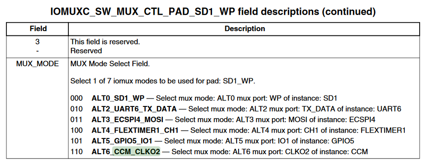

I am trying to get 32Khz on CCM_CLKO2.
CCM_CLKO2 is connected to SD1_WP of IMX7D .
My question is..how to write the device tree to generate 32khz clock on CCM_CLKO2.

Hi surya,
As you may know each pin on i.MX devices has up to 8 potential functions, and on the other side, one function can be available in different pins.
I assume you are aware that  CCM_CLKO2 can be mapped to 2 output pins.
Well, you must configure one of these output pins to take CCM_CLKO2 functionality. E.g.
You need to do this through the Device Tree (dts file).
The Device Tree is a data structure for describing hardware that is passed to the operating system at boot time. The data structure can hold any kind of data as internally it is a tree of named nodes and properties. Nodes contain properties and child nodes, while properties are name–value pairs.
Example:
pinctrl_uart2: uart2grp {
                    fsl,pins = <
                            MX6QDL_PAD_EIM_D26__UART2_TX_DATA       0x1b0b1
                            MX6QDL_PAD_EIM_D27__UART2_RX_DATA       0x1b0b1
So, how to configure what you need?
1) In the IO Pinmux chapter of Reference Manual you can find following registers:
IOMUXC_SW_MUX_CTL_PAD_<xxx> which indicates the mux function associated with the pin
IOMUXC_SW_PAD_CTL_PAD_<xxx> that is responsible for configuring the physical drive characteristic of the pin, which could be mapped to any of the pin functions.
Here <xxx> is the corresponding pin name.
In the example above the Hex number indicates the value of IOMUXC_SW_PAD_CTL_PAD_<xxx>.
2) Somewhere in you build directory you will find a file named imx6q-pinfuc.h here you will find macros with the following format:
<device>_PAD_<pin name>__<function> (please note double underscore between pin name and function)
In the example above the macro indicates the value of IOMUXC_SW_MUX_CTL_PAD_<xxx>
3) Finally just write/modify the appropriate node in the device tree with the appropriate macro and the desired pin characteristics

As per your instruction, i have muxed CCM_CLKO2 to sd1_wp in device tree.
"MX7D_PAD_SD1_WP__CCM_CLKO2      0x14".
Now, i got 24Mhz clock on the CCM_CLKO2 . But my requirement is to get 32Khz.
 The file need to be modified is "arch/arm/mach-imx/clk-imx7d.c".
