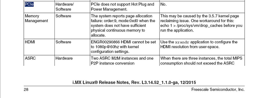

igorpadykov
Hi Chrisitian
this may be due to ERR005723
igor
5,290 Views
myungjukim
Hi, igor
hmm, Your information's means.. It don't support hot plug and power management, current and future.
and then, Is it possible as below scheme ? Could you tell me possible scheme for example ?
<pcie> - <usb controller> - <wifi> : static connection(always connected with boot, is not plug)
<pcie> - <usb controller> - <enet>: static connection(always connected with boot, is not plug)
Best regards.
