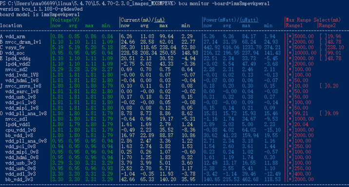

Hi @richard_hu :
Please refer to the result on my side.
BSP 5.4.70:
 BSP 6.6.52
Please let me know the detailed steps to reproduce this issue .

I have summarized the PMIC output measurements for average power consumption and have prepared a comparison table below:
LocationYocto 4.0 (5.4) Avg Power (mW)Yocto 5.0 (6.6) Avg Power (mW)Difference (mW)Change
A vdd_arm9.3624.1914.83Increased

It appears that vsys_5v and vdd_soc have increased by approximately 2022 mW in the Linux 6.6 kernel.
Could you provide any insights into the possible causes of this increase?

danielchen
Hi @richard_hu
The power consumption is highly dependent on the application.
Since there is a big change between the two BSP versions.     the device tree are also different.  It is hard to make a simple comparison.  Please refer to the total power consumption I tested on BSP 6.6.52,  idle.
