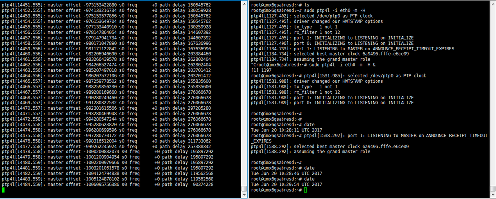

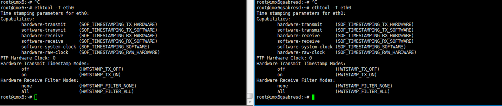

I use the officially provided image directly, support ethtool, ptp4l commands in the image, and support hard timestamps. ethtool executes as shown below:
However, I use the ptp4l tool to perform clock synchronization. The master offset has been increasing and has been in the s0 state, as shown in the figure:
Looking forward to your reply, thank you

The IEEE 1588 protocol is completely implemented in the Linux driver, there is nothing to add here.
The protocol only synchronizes the hardware clock frequencies, not the time counter values.

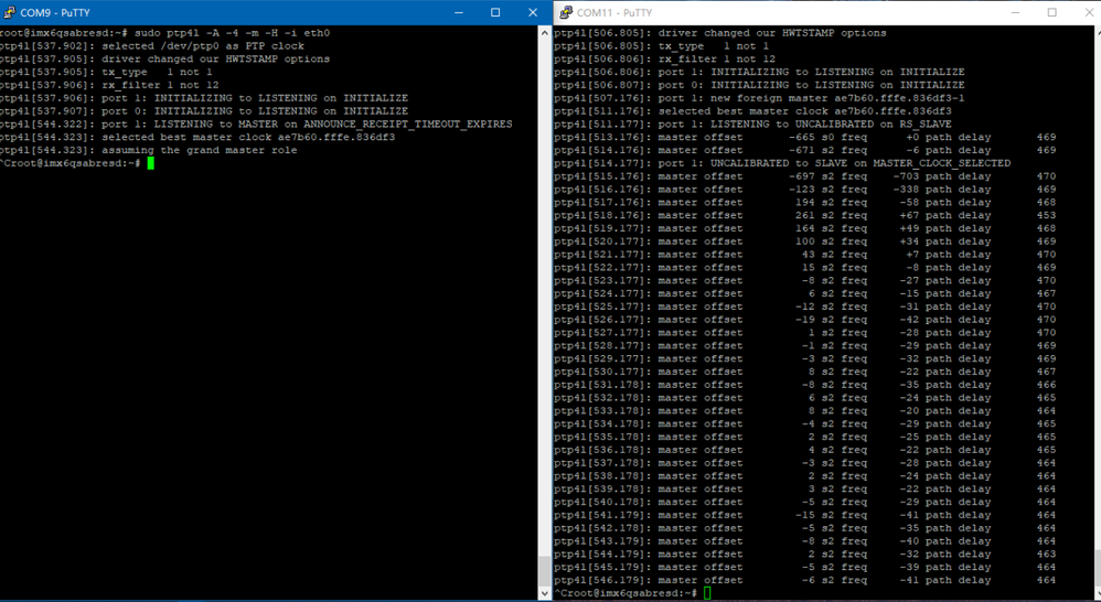

Hello there;
   First of all, I am very grateful for your help to me during this time! But I still have problems.
   1. I used two identical boards, one as the master clock and one as the slave clock. Using ptp4l for clock synchronization, the master offset value is around a single digit, but the system time has not changed.

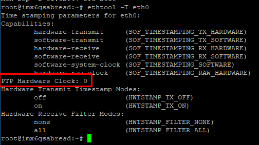

   2. "ptp hardware clock: 0" What is the meaning of this sentence? If it is 0, can you still perform hard timestamp synchronization? If not, then how can I solve this problem?
   Looking forward to your reply, thank you!
21,694 Views
art
1. Since the master offset time units are nanoseconds, the clock adjustment may just be too small to be reflected in the standard system time representation.
2. "PTP Hardware Clock: 0" is just the mnemonic name of the hardware clock selected. You can perform the hard timestamp synchronization.
