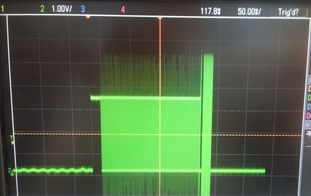

I made our board with MCIMX6Q5EYM10AD . but it dose not work in sdcard boot and uart . i made sure boot mode(10)and boot_mode is set (bt_cfg1[7..5] == 010).
,each voltages are OK((VDDCORE,VDDSOC:1.375V / VDRAM:1.5V/ VDDHIGH_IN: 3V , VREF_DDR:0.75).
and the boot image on the sdcard  works well on sabre board. but the SDCLK showed 347khz at once and go down. What do i check on our board to work with sdcard?
