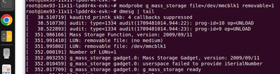

First execute the script.
After that insert the g_mass_storage module in the kernel by executing :-
modprobe g_mass_storage file=/dev/mmcblk1 removable=1
In the dmesg output, you will see something like below:-
After that you can connect a C type USB cable to the USB1 port of imx93evk and the other end to any USB ports of a laptop. The moment it is connected, you would be able to see a USB drive similar to what you get when we connect a pen-drive.
