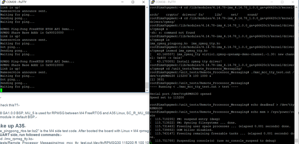

Case 1: M4 wake up A35.
Apply "L4.14.78_rpmsg_wakeup.patch" to linux kernel, this patch will enable the RPMSG wake up feature.
"rpmsg_lite_pingpong_rtos.tar.bz2" is the M4 side test code. After booted the board with Linux + M4 rpmsg software, run followed test commands:
1. In A35 UART side, run followed commands:
    # echo enabled > /sys/bus/platform/devices/90000000.rpmsg/power/wakeup
    # insmod ./imx_rpmsg_tty.ko
    # /unit_tests/Remote_Processor_Messaging/mxc_mcc_tty_test.out /dev/ttyRPMSG30 115200 R 100 1000 &
    # echo deadbeaf > /dev/ttyRPMSG30
    # echo mem > /sys/power/state
2. M4 UART side:
   After run "echo deadbeaf > /dev/ttyRPMSG30" from Linux side, it will show "Got ping..." and wait there, after run A35 suspend commane "echo mem > /sys/power/state", Linux suspends. Then from M4 UART side, press "c" key, it will send RPMSG to A35 and wake up A35 Linux.

Hi Sir,
I follow your Case 1 step and can go through test command , when I press "c" key  , my imx8qxp mek A35 not wake up .
I need re-config kernel or u-boot ?
Sorry, I missed followed line to enable RPMSG as wakeup source for case 1, now it is updated.
Hi Sir,
Thanks~ It's work.
