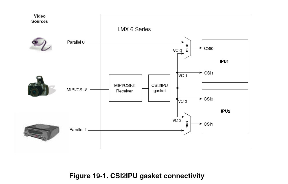

For iMX6DQ, there are two IPUs, so they can support up to 4 cameras at the same time. But the default BSP can only support up to two cameras at the same time.
The attached patch can make the BSP support up to 4 cameras based on 3.10.53 GA 1.1.0 BSP.
The 4 cameras can be:
- 1xCSI, 3xMIPI
- 2xCSI, 2xMIPI
- 4xMIPI
For 4xMIPI case, the four cameras should be combined on the single MIPI CSI2 interface, and each camera data should be transfered on a mipi virtual channel.

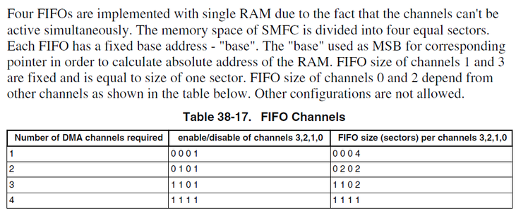

2021-04-26 update:
Some customer reported, when system loading is heavy, sometimes, some camera will flicker left and right. It is caused by SFMC FIFO data lost. The original patch used IDMAC 0 and IDMAC 1 for two cameras on one IPU, this is not the best setting.
IDMAC 1 is fixed to use 1/4 SMFC FIFO and it will cause IDMAC 0 to use 1/4 SMFC FIFO too. And another 1/2 of SMFC FIFO can't be used in this case.
Some code update to improve it:
For each IPU, please use IDMAC 0 and IDMAC 2 to capture the two cameras.
This needs change the hard coding in "drivers\media\platform\mxc\capture\ipu_csi_enc.c",
"CSI_MEM1" and "IPU_IRQ_CSI1_OUT_EOF" should be changed to "CSI_MEM2" and "IPU_IRQ_CSI2_OUT_EOF". In this case, all SMFC FIFO can be used.
And in "ipu_common.c", function ipu_probe(), the followed code should be changed to make IDMAC2 use high priority too.
/* Set sync refresh channels and CSI->mem channel as high priority */
- ipu_idmac_write(ipu, 0x18800003L, IDMAC_CHA_PRI(0));
+ ipu_idmac_write(ipu, 0x1880000FL, IDMAC_CHA_PRI(0));

1xCSI, 3xMIPI,  what does it meanning?
Hi qiang,
- 1xCSI, 3xMIPI
- 2xCSI, 2xMIPI
- 4xMIPI
可以解释一下上面的CSI和MIPI什么意思吗?不知道这个csi是指ipu内部的csi0-3 还是camera mipi总线。
