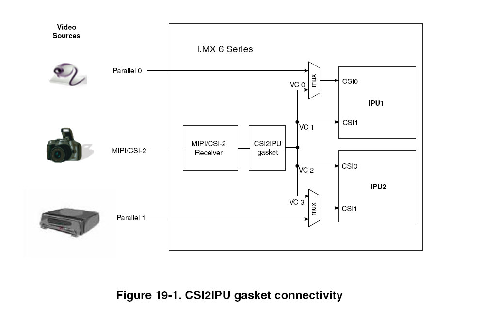

For iMX6DQ, there are two IPUs, so they can support up to 4 cameras at the same time. But the default BSP can only support up to two cameras at the same time.
The attached patch can make the BSP support up to 4 cameras based on 3.10.53 GA 1.1.0 BSP.
The 4 cameras can be:
- 1xCSI, 3xMIPI
- 2xCSI, 2xMIPI
- 4xMIPI
For 4xMIPI case, the four cameras should be combined on the single MIPI CSI2 interface, and each camera data should be transfered on a mipi virtual channel.

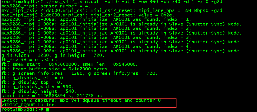

"mxc_v4l2_tvin_max9286.tar.gz" is the test application, test command to capture the four cameras and render on 1080P HDMI display:
/mxc_v4l2_tvin.out -ol 0 -ot 0 -ow 960 -oh 540 -d 1 -x 0 -g2d &
/mxc_v4l2_tvin.out -ol 960 -ot 0 -ow 960 -oh 540 -d 1 -x 1 -g2d &
/mxc_v4l2_tvin.out -ol 0 -ot 540 -ow 960 -oh 540 -d 1 -x 2 -g2d &
/mxc_v4l2_tvin.out -ol 960 -ot 540 -ow 960 -oh 540 -d 1 -x 3 -g2d &

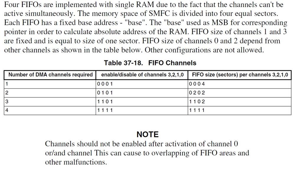

2021-04-26 update:
Some customer reported, when system loading is heavy, sometimes, some camera will flicker left and right. It is caused by SFMC FIFO data lost. The original patch used IDMAC 0 and IDMAC 1 for two cameras on one IPU, this is not the best setting.
IDMAC 1 is fixed to use 1/4 SMFC FIFO and it will cause IDMAC 0 to use 1/4 SMFC FIFO too. And another 1/2 of SMFC FIFO can't be used in this case.
Some code update to improve it:
For each IPU, please use IDMAC 0 and IDMAC 2 to capture the two cameras.
This needs change the hard coding in "drivers\media\platform\mxc\capture\ipu_csi_enc.c",
"CSI_MEM1" and "IPU_IRQ_CSI1_OUT_EOF" should be changed to "CSI_MEM2" and "IPU_IRQ_CSI2_OUT_EOF". In this case, all SMFC FIFO can be used.
And in "ipu_common.c", function ipu_probe(), the followed code should be changed to make IDMAC2 use high priority too.
/* Set sync refresh channels and CSI->mem channel as high priority */
- ipu_idmac_write(ipu, 0x18800003L, IDMAC_CHA_PRI(0));
+ ipu_idmac_write(ipu, 0x1880000FL, IDMAC_CHA_PRI(0));

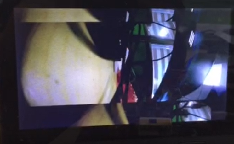

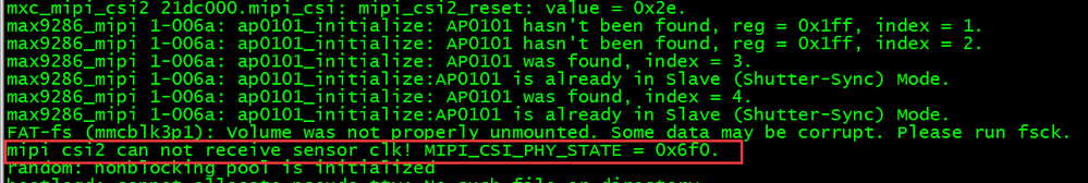

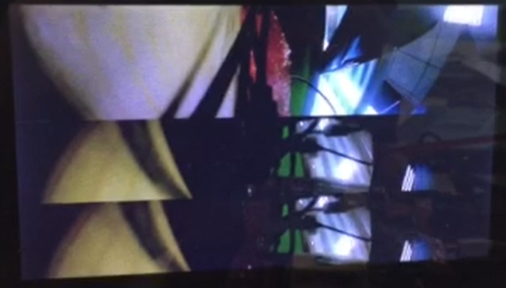

dqz
Thank you for your reply,
the camera is working in sync mode.
sometime i can connect two camrea successfully:
max9286_mipi: sensor number = 2.
mxc_mipi_csi2 21dc000.mipi_csi: mipi_csi2_reset: mipi_lane_bps = 336 Mbps
mxc_mipi_csi2 21dc000.mipi_csi: mipi_csi2_reset: value = 0x2a.
max9286_mipi 1-006a: ap0101_initialize: AP0101 was found, index = 1.
max9286_mipi 1-006a: ap0101_initialize:AP0101 is already in Slave (Shutter-Sync) Mode.
max9286_mipi 1-006a: ap0101_initialize: AP0101 was found, index = 2.
but when i try to get image,the image is not  normal,
the clock configure is not right? g_sensor_num = 2  lanes = 3
mipi_csi2_reset(mipi_csi2_info, (672* g_sensor_num) / (lanes + 1));
I think you still need check and tuning your ISX016 camera setting, the reference code is for AP0101+AR0140 camera board.

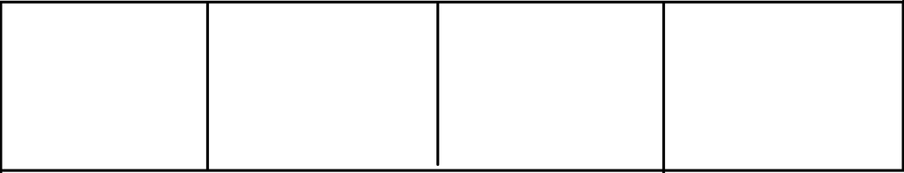

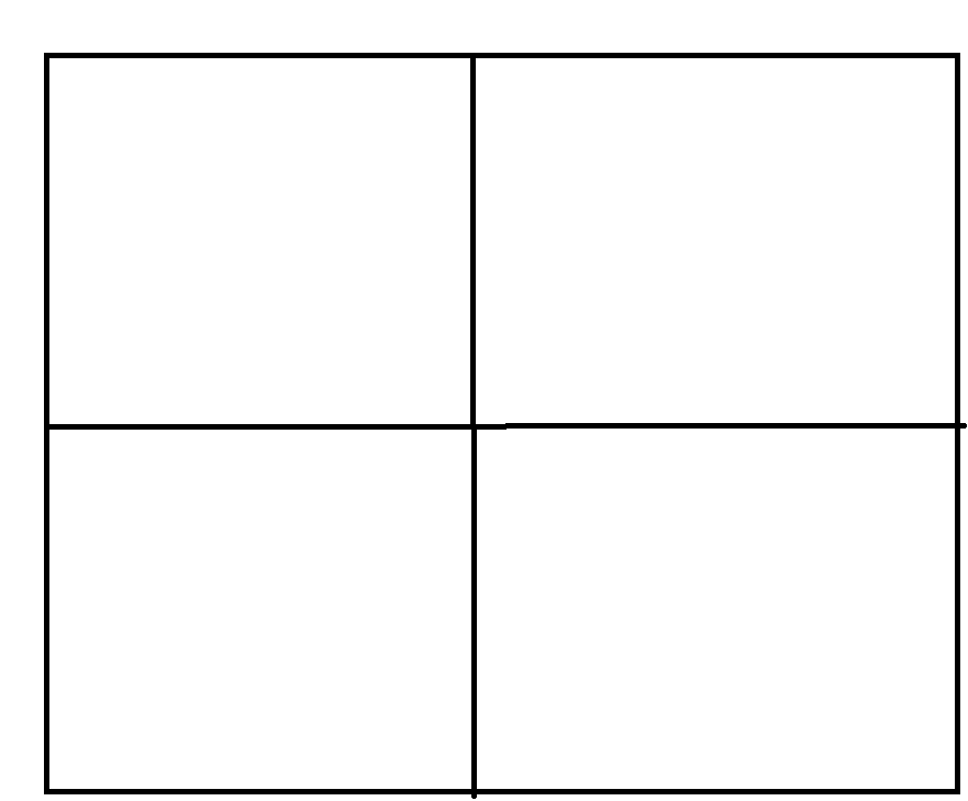

Qiang_FSL‌  @zhang hongliang
i want to put the four Independent camera data together in the ipu driver like one of below image , so then user can just use once DQBUF call to get all the four camera data.
Any suggestions?
or
You can alloc a big buffer array for V4l2 capture driver with 2560*1440 pixel buffers:
For camera 1, let its DMA buffer base address to pixel (0, 0), width 1280, height 720, but set the stride to 1280*2*2; then after filled 1280 pixels (1280*2 bytes for UYVY input), it will jump 1280*2*2 bytes; so camera 1 will fill the left-up 1280*720 pixels of the buffer;
For camera 2, let its DMA buffer base address to pixel (1280, 0), width 1280, height 720, but set the stride to 1280*2*2; then after filled 1280 pixels (1280*2 bytes for UYVY input), it will jump 1280*2*2 bytes; so camera 2 will fill the right-up 1280*720 pixels of the buffer;
For camera 3, let its DMA buffer base address to pixel (0, 720), width 1280, height 720, but set the stride to 1280*2*2; then after filled 1280 pixels (1280*2 bytes for UYVY input), it will jump 1280*2*2 bytes; so camera 3 will fill the left-down 1280*720 pixels of the buffer;
For camera 4, let its DMA buffer base address to pixel (1280, 720), width 1280, height 720, but set the stride to 1280*2*2; then after filled 1280 pixels (1280*2 bytes for UYVY input), it will jump 1280*2*2 bytes; so camera 4 will fill the right-down 1280*720 pixels of the buffer.

When you used IPU for CSC on 1280*720 frames, the IPU loading is heavy, there is chance that IPU can't service the capture on time.
To improve it, you need use IDMAC 0 and IDMAC 2, then all FIFO can be used:
In ipu_common.c, function ipu_probe(), please make sure all CSI->MEM channels are set to high priority:

1) the MIPI_IPU1_MUX and MIPI_IPU2_MUX are set to 0 for mipi_csi

Hi Lion, no special modification is needed on iMX6 side, you should tune the Ti chip setting.
As I know, some customer had already make the Ti 964 work on iMX6 platform, the main work is in Ti side, you should check with them. For iMX6, you just need make sure the four cameras is transfered on 4 MIPI virtual channel.

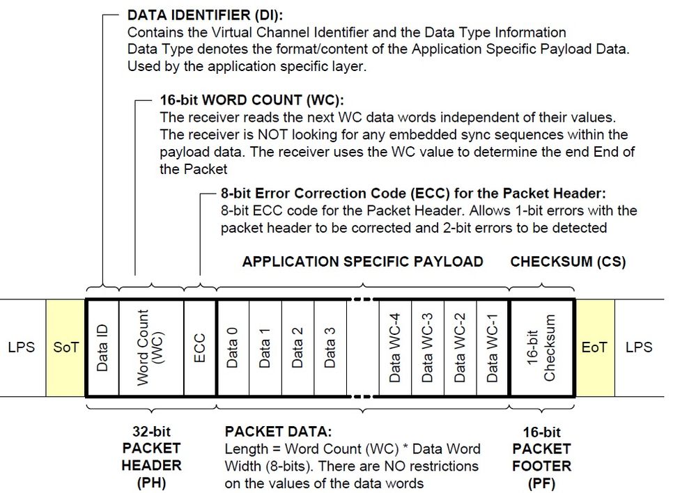

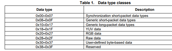

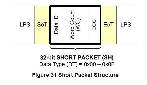

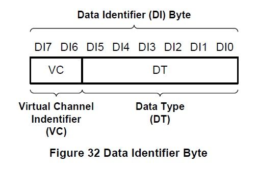

Hi lionwei Qiang_FSL ;
According to iMX6 CSI2IPU documentation we need to create  short or long type packages  and also we need Start Of Transmission and End Of Transmission packages too,
How can I send this packages for example in the camera device driver source this packages should be created and sent these data types or we are defining these values to another files . What is the format of SoT and EoT packages?
Can someone give me any example about that, I have been working to solve the csi2 format mipi clock and data lane problem, I couldnt define to the iMX6Q processor custom board since 3 week. It would be very very appreciated.
Best Regards
Hi Mustafa, the information can be found from MIPI CSI2 specification:
Hi Lion,
The MIPI CSI2 error registers can be used to check the MIPI CSI2 package is correct with CRC or follows the protocol.
Thank you for respond Qiang_FSL
I am now looking at the MIPI CSI2 Reference Documentation , I am checking all. Also I made search on the my imx6q(Wandboard Quad) custom board source and header files. After my research I could not find  relative source code in the my kernel files, which defines packet types and communication sub-structures for CSI-2 Interface Low Level Protocol message protocol , SoT and EoT package sample codes. I will take the video by using  "mxc" relative files and it's ipu source codes. So If you can share any source code or any relative codes which informs me about  SoT,EoT and LLP Massage Package Structures sample codes, It would be very nice and useful for me because I don't have any reference code in my kernel files.
Best Regards.
Hi Mustafa,
These packages are implemented by the MIPI CSI2 hardware, from software side, we just tell it the virtual channel number and Data Identifier (It can be found at include\linux\mipi_csi2.h).
Hi Qiang
thanks for your help!
after tune the ti settings, I can receive four camera data now.
currently for 1/2/3 sensors, I can receive the data with correct pixels
however for 4 sensors, the pixel data has some line corruptions(see the below picture)
from TI side, we can set the data lane numbers and data lane rate
however, the data lane rate has only three options(400M, 800M, 1.6G)
with different rate+lane number setting, the 1/2/3 sensors can work perfectly
for 4 sensors, only 800M+4 data lanes works, but the data has some corruptions
my question is
1) for imx6 mipi csi2 receiver, is there any special requirement on the rate and data lanes setting?
2) for imx6 mipi csi, what is the suitable ratio between the real data rate and the total data capability?
2) any suggestions?
Hi Lion Wei, the MAX throughput for IMX6 MIPI CSI2 is 3.2Gbps in 4 lanes mode, so each camera can be up to 800Mbps (include blank data).
And the followed code should be adjust for your real camera, the 768 should be your real camera bps:
 /* 48MHz pixel clock (1280*800@30fps) * 16 bits per pixel (YUV422) = 768Mbps mipi data rate for each camera */
 mipi_csi2_reset(mipi_csi2_info, (768 * g_sensor_num) / (lanes + 1));
Anoter limitation, at least 3 blank lines are needed for two frames from camera.

Qiang Li,我现在在调MAX96705+AP0101+AR0141,基于Linux 3.14.52版本,提示错误信息如下,请帮忙看看是哪里出了问题。
-oh 540 -d 1 -x 0 -g2da/usb/CameraTest# ./mxc_v4l2_tvin.out -ol 0 -ot 0 -ow 960
[ 34.334381] max9286_read_reg 0x49 = 1.
[ 34.338883] mipi_csi2_set_lanes = 3.
[ 34.342494] mxc_mipi_csi2 21dc000.mipi_csi: mipi_csi2_reset: mipi_lane_bps = 148 Mbps
[ 34.350399] mxc_mipi_csi2 21dc000.mipi_csi: mipi_csi2_reset: value = 0x42.
[ 34.555059] max9286_mipi 2-006a: ap0101_initialize: AP0101 was found, index = 1.
[ 34.563125] max9286_mipi 2-006a: ap0101_initialize:AP0101's 0xC88D is 0x0.
[ 34.570775] max9286_mipi 2-006a: ap0101_initialize:AP0101 is not in Host Configuration Mode. reg = 0x4.
[ 34.580281] max9286_mipi 2-006a: ap0101_initialize:AP0101's 0xdc07 is 0x4.
[ 36.453930] max9286_mipi 2-006a: ap0101_IssueHostCommand: timeout.
[ 36.460877] max9286_mipi 2-006a: ap0101_ApplyPatch: PATCH_APPLY_PATCH error.
[ 36.468012] max9286_mipi 2-006a: ap0101_LoadAp0101Patch: Patch111 load failed, result = 1794
[ 36.476664] max9286_mipi 2-006a: ap0101_initialize: LoadAp0101Patch failed, result = 1794

g_in_width = 1280, g_in_height = 720.
fb_fix.id = DISP3 FG.
fb: smem_start = 0x24a00000, smem_len = 0xbdd800.
fb: frame buffer size = 0x3f4800 bytes.
fb: g_screen_info.xres = 1920, g_screen_info.yres = 1080.
fb: g_display_left = 0.
fb: g_display_top = 0.
fb: g_display_width = 960.
fb: g_display_height = 540.
start time = 1481829237 s, 120527 us
[ 47.283991] ERROR: v4l2 capture: mxc_v4l_dqueue timeout enc_counter 0
VIDIOC_DQBUF failed.
"ap0101_initialize:AP0101 is not in Host Configuration Mode"
This log means the camera is not in I2C config mode, so we can't initialize it. You need check your camera board, if it has flash on board, then you need update the flash ROM setting with the driver's. You can also remove the flash ROM on camera board, then the MAX9286 driver can initialize it with I2C commands.
