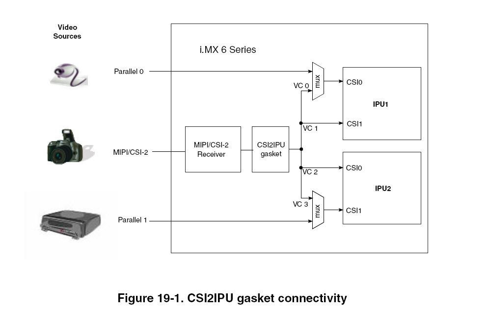

Hi llinguo, this patch is for iMX6D/Q which has 2 IPU and can support up to 4 MIPI virtual channel.
In fact, ISL79987 can merge two cameras into one MIPI virtual channel, in this case, iMX6S/DL can also receive 4 cameras on two MIPI virtual channel, but we haven't implemented it, and no plan to support it.

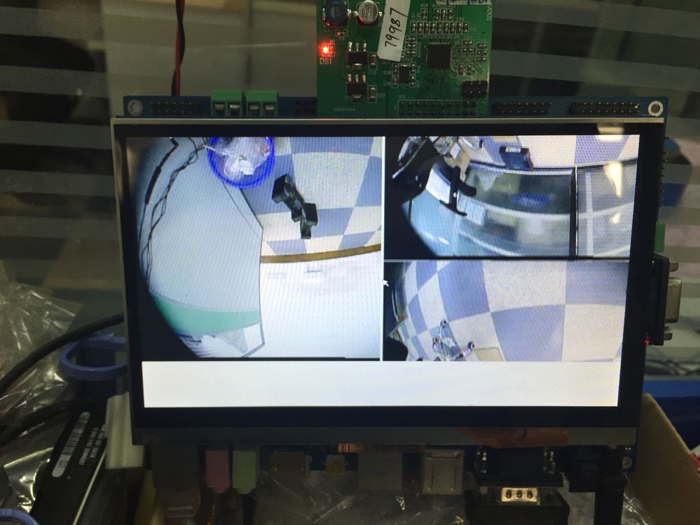

I use the demo which you provided, can display and switch between 0~3 camera.
But i hope to operate ISL79985 once, and display 4 camera to one screen.
Do ISL79985 has this function?
if any, Which register should I operate?
Hi Jiang xmen, you can create your own test application to get video from four cameras and render them to display once.

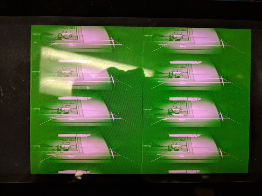

I use imx6Q+isl79987 kernel 3.14.52 , and i capture in 720*480,
I use L3.10.53_ISL7998x_Surroundview_Patch_20161121 patch to edit kernel, and test ok!
I found a problem, when I test video0,video1,video2,video, open is ok!
but video output image is always scrolling.
can you tell me what can I do?
thank you !

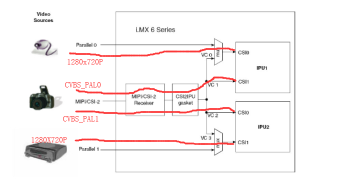

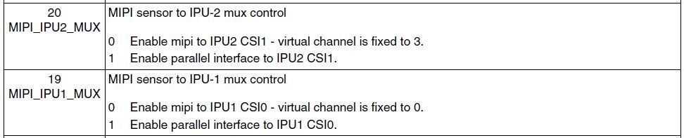

Maybe you are using PAL cameras, this patch is set to NTSC camera in default. You can check it.
Hi Qiang:
I have test PAL and NTSC fmt, but it not work ok.
and then I debug in kernel, I found there is Tow IPU in IMX6Q,
and  video0, video1  used ipu0,     video2, video3  used ipu1,
video0 , video2 : CSI  IC  MEM;  (ipu_prp_enc.c)
video1 , video3 : CSI   MEM;   (ipu_csi_enc.c)
The result is video0, video2 is work OK.
BUT video1 , video3 is always scrolling.
It's very strange.
Can you tell me what can I do ?
Thank You Very Match!!!
the picture is video0, video1,  Left is video0, it work ok,  Right is video1, it scrolling.
Hi Jiang xmen, I think you should reference to the mxc_v4l2_tvin test application in this document, for this use case, all cameras should use CSI->MEM path to capture.
I duplicated the initial steps of this article using NXP's 4.1.15 kernel on an i.MX6D integrating the above patches, but we have our own unique IMX6D Carrier board.   This board only has video capture of the ISL79987 connected to the MIPI port using 2 data lanes (exactly like described above), so I feel we should be clean on our implementation  (very similar to SabreSD), but when I power it up I see this:
As you can see, it is an image replicated 8 times on the screen with no / bad color...
Each of the smaller images looks to be correct.   The camera I am using has IR Lighting which is why there is a bright image in the middle, but other than this, the Black & White component of the video look OK.
I have to admit I am completely new to MIPI, so at this point, I am not sure where to start my search...   I have used the ISL TW Terminal to ensure the input decoder is working correctly, and it is.   I have enabled the On Chip Pattern Generator, but it too is displayed as 8 smaller images.  I have reviewed my configuration against another post on this site with regard to verifying MIPI configurations, and it seems I have things correct, but still I have this issue.
Does someone recognize the above image and a possible solution?   Of if not, how about details of setup & diagnostics of a multi camera MIPI configuration like the ISL79987?
Many thanks in advance...

HI ,Qiang Li:
     (1) 同时使用4路TVIN(2xCSI, 2xMIPI),用了3颗AD芯片连接到imx6d三个camera接口上,
     (2) IMX6D+L3.10.53+L3.10.53_ISL7998x_Surroundview_Patch_20161121 patch.
     (3) GPR1配置: bit19 is 1, bit20 is 1
     发现问题parallel0和parallel1正常,CVBS_PAL0和CVBS_PAL1不正常,不知是何原因,能不能给些建议?
非常感谢!!
CVBS_PAL0需要从MIPI的Virtual channel 1去抓取,CVBS_PAL1需要从MIPI的Virtual channel 2去抓取,MIPI camera驱动需要实现好。

Hi, I am using ISL79987 and need to run as MIPI CSI2.
The virtual channels 1 and 2 are working, but the virtual channels 0 and 3 aren't working.
Channels 0 and 3 return this error:
# ./mxc_v4l2_tvin.out -ol 0 -ot 0 -ow 1280 -oh 720 -d 1 -x 0 -g2d
g_in_width = 720, g_in_height = 480.
fb_fix.id = DISP3 FG.
fb: smem_start = 0x85000000, smem_len = 0x546000.
fb: frame buffer size = 0x1c2000 bytes.
fb: g_screen_info.xres = 1280, g_screen_info.yres = 720.
fb: g_display_left = 0.
fb: g_display_top = 0.
fb: g_display_width = 1280.
fb: g_display_height = 720.
start time = 1545671531 s, 683461 us
[ 379.992842] ERROR: v4l2 capture: mxc_v4l_dqueue timeout enc_counter 0
VIDIOC_DQBUF failed.
Can anybody help me?
Hi Dionevã Krolow, please make sure you had disabled other camera drivers (such as ov5640) from device tree and kernel config files. Another thing can be checked is the IOMUX_GPR1 register setting, BIT 20 and BIT 19 should be 0 to map MIPI VC 0 and 3 to IPU CSI port.
The code is in arch\arm\mach-imx\mach-imx6q.c, function imx6q_csi_mux_init().
Hi Qiang Li - Mpu Se, it is working thank you very much!!!!! :smileygrin: :smileygrin: :smileygrin:
