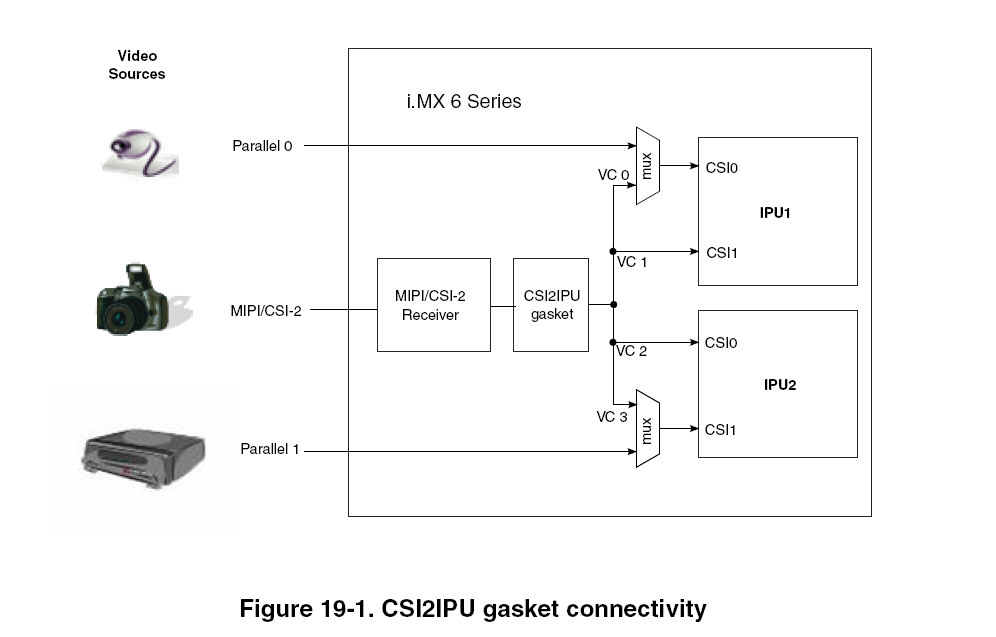

For iMX6DQ, there are two IPUs, so they can support up to 4 cameras at the same time. But the default BSP can only support up to two cameras at the same time.
The attached patch can make the BSP support up to 4 cameras based on 3.10.53 GA 1.1.0 BSP.
The 4 cameras can be:
- 1xCSI, 3xMIPI
- 2xCSI, 2xMIPI
- 4xMIPI
For 4xMIPI case, the four cameras should be combined on the single MIPI CSI2 interface, and each camera data should be transfered on a mipi virtual channel.
In this patch, we given the example driver for Intersil ISL79985. The input to ISL79985 is four CVBS camera.

iMX6DL can only support up to two MIPI virtual channel at the same time (Due to there is only one IPU). So this patch can't work on it.
ISL79987 can combine two cameras into one MIPI virtual channel, in this case, it can be used on iMX6DL, then after received each combined frame, the software should split it to two pictures for two camera. I haven't verified such use case, you can check with Itersil for how to set ISL79987 in such mode.

with imx6DL ,can i just use 2 channel input and 2 lane output? one IPU can process 2 channel.
is this can work ?
That is OK.
dqz
i have patched the patch file , if i want to use two input and 2 lanes mipi output ,what should i change the code in isl7998x_mipi.c?
Thanks for you clarification, that's clear my doubt.
So for isl79985, our options are either keep all fields and accept the flickering as in you current patch, or drop all the even or odd fields as in you previous patch? Unless we are able to determine the odd/even field somehow.
I think you should focus on IOMUX_GPR register setting to map the two cameras to VC 0 and 1 on IPU CSI0 and CSI1.
In isl7998x_mipi.c, you can set max camera numbers to 2.

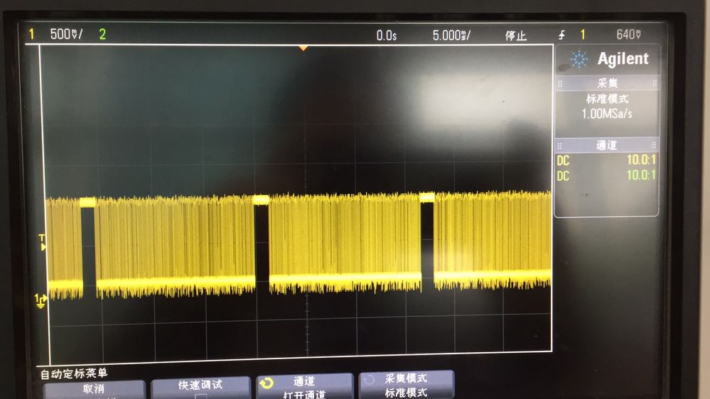

my bsp is 3.10.53, i have patched the patch files ,and there is no other camera drivers installed,but when i run mxc_v4l2_tvin_isl7998x,it always printf:
 SENSOR_NUM 4 lanes 1
mxc_mipi_csi2 21dc000.mipi_csi: mipi_csi2_reset: mipi_lane_bps = 432 Mbps
mxc_mipi_csi2 21dc000.mipi_csi: mipi_csi2_reset: value = 0xc.
g_in_width = 720, g_in_height = 480.
fb_fix.id = DISP3 FG.
fb: smem_start = 0x72800000, smem_len = 0xbdd800.
fb: frame buffer size = 0x3f4800 bytes.
fb: g_screen_info.xres = 1920, g_screen_info.yres = 1080.
fb: g_display_left = 0.
fb: g_display_top = 0.
fb: g_display_width = 960.
fb: g_display_height = 540.
start time = 12 s, 553006 us
ERROR: v4l2 capture: mxc_v4l_dqueue timeout enc_counter 0
VIDIOC_DQBUF failed.
i use oscillometer to measure MIPI_CLK MIPID0 MIPID1 i can get signal.

What did you do to fix your problem?  I'm seeing the same error message "mipi csi2 can not receive sensor clk! MIPI_CSI_PHY_STATE = 0x200."
# ./mxc_v4l2_tvin.out -ol 0 -ot 0 -ow 960 -oh 540 -d 1 -x 0 -g2d
g_in_width = 720, g_in_height = 240.
fb: smem_start = 0x44800000, smem_len = 0x708000.
fb: frame buffer size = 0x258000 bytes.
fb: g_screen_info.xres = 1024, g_screen_info.yres = 600.
start time = 1498657957 s, 147951 us
dqz‌ and Qiang_FSL‌,
I am also getting the
error when I run: ./mxc_v4l2_tvin.out -ol 0 -ot 0 -ow 960 -oh 540 -d 1 -x 0 -g2d
Any thoughts on what this error may be?  I am using the ISL79985 on 4.1.15 kernel.
"mipi csi2 can not receive sensor clk! MIPI_CSI_PHY_STATE = 0x200"
This error means iMX6 MIPI CSI2 PHY can't identify the input MIPI signal.
