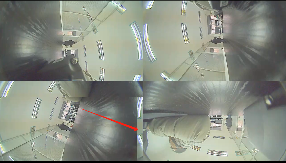

Hi Qiang Li:
I use the IMX6Q core board. Now when using both GC2000 and GC320, there are occasional image tears on the screen display.
The specific implementation is like this:
   Get the real-time video data of the 4-way camera, display it on the GPU and display it in real time on the lvds screen. At the same time, the 4 channels of video are called by g2d to call the g2g_blit function for resize. The image of each frame is 720P resize to 640*480, and then synthesized into one frame. Image so that 4 channels of video can be displayed in one frame.the spliced video is not display on the screen and saved directly into the video,but now it is found that the video displayed by the GPU rendering in real time will be torn. Playback of the saved video also found that the image has a tearing problem, affecting the viewing effect.
   If you test the GPU rendering display separately, or the video of 4 channels of video is saved by G2D synthesis, there will be no image tearing problem.
But as long as these two functions are combined into one project, the problem of image tearing will occur when displaying and the saving  video.
1. Can I use the GC2000 of IMX6 and GC320 at the same time? Is there a problem with GPU resource preemption?
2. Is there a problem with data conflicts in the GPU? I have already made the GC2000 and GC320 get data that cannot be bufed, but after the two functions are integrated, there will still be a problem of video tearing.
I think you need check the delay for each processing step, before next processing, maybe the pre-step is not finished.

According to what you mean, is the GC2000 and GC320 taking up the GPU in sequence? After the GC2000 has finished performing the on-screen rendering, can the GC320 take up GPU resources for 4-way image synthesis? Or first GC320 execution, then GC2000 re-execution? For different data buffers, can the two modules GC2000 and GC320 not run at the same time?
GC2000 and GC320 can run at the same time.
