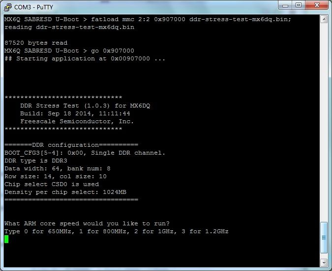

I'm using an i.MX6Q part on my board and I don't have OTG so I am following your instructions on loading from u-boot or JTAG.
JTAG I've had no luck so I thought I'd switch over to u-boot.
U-Boot > ext2load mmc 0:1 0x907000 ddr-stress-test-mx6dq.bin
96660 bytes read in 43 ms (2.1 MiB/s)
U-Boot > go 0x907000
## Starting application at 0x00907000 ...
then it just sits there and doesn't load anything further...
any ideas?
Hi Patrick,
Are you using the binary in
DDR_Stress_Tester_V1.0.3_UART1_for_SDboot&JTAG.zip or DDR_Stress_Tester_V1.0.2_UART1_for_SDboot&JTAG.zip.
Even the name is same, but the binary files in package DDR_Stress_Tester_UART1_for_SDboot&JTAG.zip and DDR_Stress_Tester.zip are different.
In my log below, you can see the load size of ddr-stress-test-mx6dq.bin is  87520, but yours is 96660.
Another point is what I mentioned before, is the RX/TX pin of  UART1 of your board same as i.MX6DQ EVK?
If not, please contact your FAE.

I don't know how I missed this, but knowing that I could launch the DDR Stress Test tool from U-Boot would have saved us a lot of time.
None of the binaries in the v1.0.2 or v1.0.3 ZIP files has a size of 87520 bytes.  My copy of ddr-stress-test-mx6dq.bin (v1.0.3) is 96660 bytes.
i.MX6DQ UART1 :
    /* UART1 TXD */
    writel(ALT3, IOMUXC_SW_MUX_CTL_PAD_CSI0_DAT10);
    /* UART1 RXD */
    writel(ALT3, IOMUXC_SW_MUX_CTL_PAD_CSI0_DAT11);
    // daisy chain setup
   writel(0x1, IOMUXC_UART1_IPP_UART_RXD_MUX_SELECT_INPUT);
If you're successfully talking to U-Boot over UART1, then it's probably already set up correctly :-).
